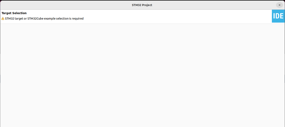

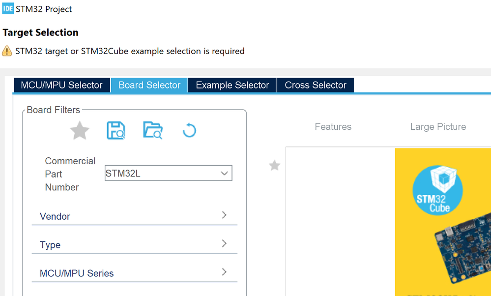

I must admit I had expected the point of a "Discovery kit" was to provide a quite polished experience, but I guess I'll get there. Right now I am trying to compile the example which was instantiated when I selected the stm32L1 Discory kit. Compilation seems to work - no errors in the console - but when I try to "Run" (whatever that means in this context) I get the following window:
