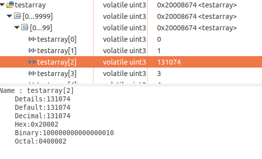

Hello, I'm using the STM32746G Discovery Board to familiarize myself with the ST environment. Now I simply wanted to store a 32Bit value in the RAM, and had several problems with the Cube BSP drivers. I tested the functions with the following code:
#define SDRAM_OFFSET ((uint32_t)0xC0100000)
for(uint32_t i=0; i<0x10010; i++){
	BSP_SDRAM_WriteData(SDRAM_OFFSET+i*4,(uint32_t *)&i,1);
	testarray[i]= 0;
if(SDRAM_OK != BSP_SDRAM_ReadData(SDRAM_OFFSET+i*4,(uint32_t *)(&testarray[i]),1)){
	testarray[i] = 111111;
In the debugger it then looks like this:
Sometimes the transfer works. Sometimes the higher bits are incorrect.
How do I use the function to make it work?

I am still struggling with this problem. Does nobody have any suggestions or tips for me?
testarray is in Internal SRAM
0x10010 is significantly larger than 10000 decimal (0..9999)
SDRAM writes like other memory, you could just use a pointer.
Thanks for the reaction. I'm not sure I understood you correctly. If I do it that way, I get exactly the same result (with 16 entries):

After trying for hours, it looks like I've found a solution. I found in the file: stm32746g_discovery_sdram.h the macro: SDRAM_MEMORY_WIDTH
I changed it from FMC_SDRAM_MEM_BUS_WIDTH_16 to FMC_SDRAM_MEM_BUS_WIDTH_8.
I have no idea what I did, but in any case the read-write check works now. Let's see what else awaits me. If someone can explain to me what I have changed there exactly, I am curious.
