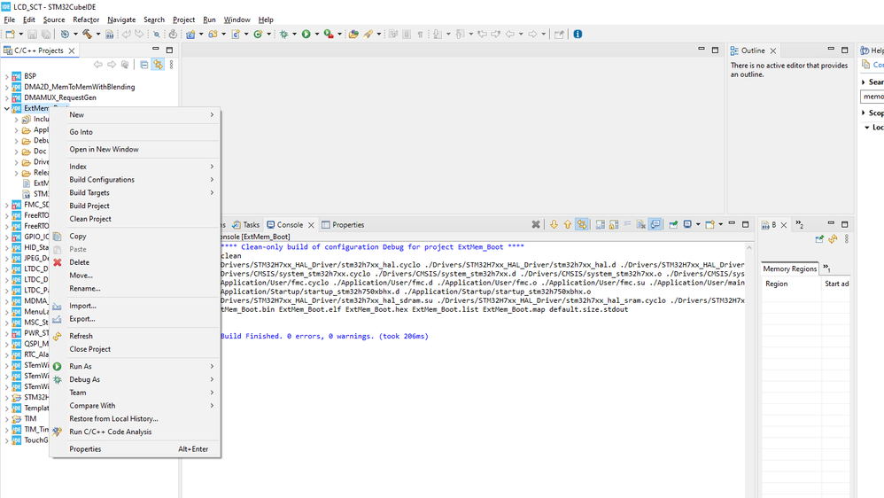

Hi and thank you for the reply.
I have opened the ExtMem_Boot project within the CudeIDE. Set the build configurations to make the *.hex file, looking to flash via the Cube Programmer.
Went on on the project with the mouse pointer and clicked the right knob and selected:
- clean project, no errors ok, continuing with the build, but build failed, get 9 errors, 11:04:28
Build Failed. 9 errors, 0 warnings. (took 575ms) , attaching the console output ...
Any idea how to fix this?

How did you download the Cube package? from github? if yes did you clone recursively the repository?
Please read this article: Downloading STM32Cube packages from GitHub correctly
Otherwise you can download the complete package directly from this link: STM32CubeH7

With ST web page, download the cube package and overwrite the files needed to be updated with the patch.
To download the H7 Cube package from the github you need to clone it with the following command:
git clone --recursive https://github.com/STMicroelectronics/STM32CubeH7.git
Please tell if you can compile the project now.
Thanks, chosen the git clone --recursive https://github.com/STMicroelectronics/STM32CubeH7.git
I guess this is the "PATCHED" version of the FW, or not?
Anyway, now I can compile the ExtMem project found in the ...Projects/STM32H750B-DK/Templates?ExtMem_Boot
Indeed, the created HEX file was also succesfully downloaded to the board...
Thank you very much for now.
Best.
Yes it is patched.
