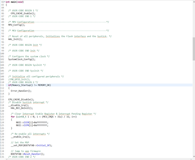

Hello everyone. I am trying to write a bootloader with STM32H750IBT6 and mt25ql512. I am trying to adapt the ExtMem_Boot example of STM32H750-DK to STM32H750IBT6 by modifying it, but I can't succeed. It doesn't make sense why STM32H750IBT6 does not work. In the software;
JumpToApplication = (pFunction) (*(__IO uint32_t*) (APPLICATION_ADDRESS + 4));
__set_MSP(*(__IO uint32_t*) APPLICATION_ADDRESS);
JumpToApplication();
but JumpToApplication(); enters HardFault and I get SCB->CFSR = 1025. Whatever I did, I was not successful. Attached I share the bootloader and application projects.

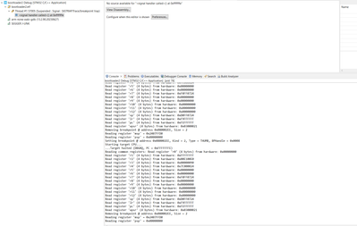

Personally I'd skip the setting of MSP, do a "LDR SP" over in the app code's Reset_Handler
Check the values in the Initial SP, PC vectors, say that (PC & 0xF0000001) == 0x90000001
Print out the values for diagnostic/telemetry purposes.
Set the SCB->VTOR in SystemInit(), ideally based off a symbol for the Vector Table the linker provides AS-BUILT
Would recommend getting UART output via STDIO (printf, puts, etc) and a viable HardFault_Handler() to report situation quickly/effectively.

Before jumping to the main application, make sure you DeInit all the clocks, peripherals, and interrupts you used in the bootloader.
in my case:
HAL_SD_MspDeInit(&hsd1);
__HAL_RCC_TIM1_CLK_DISABLE();
HAL_RCC_DeInit();
HAL_DeInit();

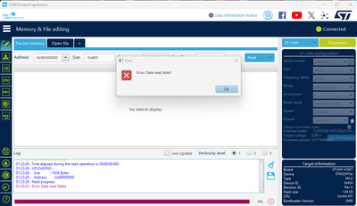

Thank you very much for your valuable comments. I have tried every method for 1 week. The processor is acting like an ***, no matter what you try, there is no change. In the STM32H750B-DK kit, in the ExtMem-Boot example, it can jump to the 0x90000000 address of the MT25QL512 flash without changing anything. But I can't jump to the 0x90000000 address with the STM32H750IBT6 and MT25QL512 flash, I'm really going crazy. Please help me with this, I really lost a lot of time.

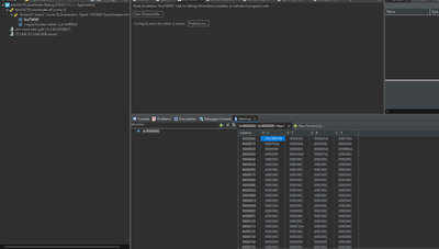

Validate the content of the External Flash, use say CRC or SHA256/MD5 and validate the content is reliably readable

Hello everyone. Thank you very much for your answers, dear authorities.
If I make the bootloader system clock 64 MHz HSI or 400MHz HSE with QSPIHandle.Init.ClockPrescaler = 10, the QSPI configuration is completed without errors. I made some changes in my main, and this time I get stuck at 0xa759000 and the system shuts down. Also, in bootloader debug state, I can read address 0x90000000, but I can't read external memory (0x900000000) in CubeProgrammer. I use "CLIVEONE-MT25QL512A_STM32H7XX-PB2-PB10-PF8-PF9-PE2-PD13.stldr" as external loader. I shared the code and images related to the events below.
/* USER CODE BEGIN Header */
  * @file           : main.c
  * @brief          : Main program body
  * @attention
  * Copyright (c) 2024 STMicroelectronics.
  * All rights reserved.
/* USER CODE END Header */
#include "main.h"
#include "memory.h"
/* USER CODE END Includes */
/* USER CODE BEGIN PTD */
typedef  void (*pFunction)(void);
/* USER CODE END PTD */
/* USER CODE BEGIN PD */
/* USER CODE END PD */
/* USER CODE BEGIN PM */
/* USER CODE END PM */
QSPI_HandleTypeDef hqspi;
/* USER CODE BEGIN PV */
pFunction JumpToApplication;
/* USER CODE END PV */
static void MPU_Config(void);
static void MX_QUADSPI_Init(void);
/* USER CODE BEGIN PFP */
static void CPU_CACHE_Enable(void);
static void CPU_CACHE_Disable(void);
static void MPU_Config (void);
static uint32_t Memory_Startup(void);
/* USER CODE END PFP */
/* USER CODE BEGIN 0 */
/* USER CODE END 0 */
  * @brief  The application entry point.
  * @retval int
int main(void)
  /* USER CODE BEGIN 1 */
	  CPU_CACHE_Enable();
  /* USER CODE END 1 */
  /* MPU Configuration--------------------------------------------------------*/
  MPU_Config();
  HAL_Init();
  /* USER CODE BEGIN Init */
  /* USER CODE END Init */
  SystemClock_Config();
  /* USER CODE BEGIN SysInit */
  if(Memory_Startup() != MEMORY_OK)
    Error_Handler();
  CPU_CACHE_Disable();
  HAL_RCC_DeInit();
  for(int i = 0; i < 8; i++){
	  NVIC->ICER[i] = 0xFFFFFFFF;
	  __DSB();
	  __ISB();
  SysTick->CTRL = 0;
  SCB->VTOR = APPLICATION_ADDRESS;
