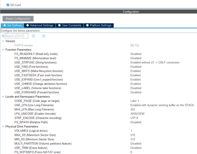

I am using an STM32H725IGK MCU on a custom board. My board has a uSD card slot connected to the SDIO pins, and I am using SDMMC1 peripheral. I am also using FatFS to use a filesystem on the uSD card.
I can operate the SD card properly most of the time. I can mount, format, create files and folders, and read and write to files. However, sometimes, some operations fail. Normally, it's either f_write or f_lseek. They fail at the low-level disk_read() operation. I do not understand why.
I will share my system configuration:
- Clock MUX:
- SDMMC Parameters:
The clock divide factor of 2 gives 32 MHz. I also tried setting the clock to 16 MHz and 8 MHz, but the problem persists.
- SDMMC GPIO settings:
I also adjusted the output speed of the pins to guarantee the signal integrity is good, but the issue remains.
- FatFS defines:
- FatFS Advanced Settings:
My system also utilizes FreeRTOS, and I use semaphores to ensure that only one task accesses the SD card at a time. I have the FS_REENTRANT disabled.
I tried SD cards from different brands and different sizes. It seems that 16 GB cards work better, but still fail. The 32 GB fails more often.
Is there a limitation on the number of bytes that I can use on f_write or f_lseek? Is there a problem with my configuration that I'm not seeing? Do I have to use multiples of the maximum sector size, 512, in my configuration?
Any help is deeply appreciated. I've been stuck with this issue for a while now.

My buffers are in RAM_D1. It seems that the problem is related to threads. When only the SD card thread is active, the system operates correctly, even when writing 4096 bytes every 2 milliseconds. I already tried setting the SDMMC interrupt priority higher than all the others, but it still does not solve the issue. By setting the SD card thread with the highest priority, I avoid errors. However, the rest of the system eventually fails.
I need to better understand the impacts of the other threads on the SD card operation and vice versa.

I have done a test that seems to indicate that the issue is not on the hardware. Once the SD card was detected, I opened a file and started writing 2048-byte blocks with f_write, every millisecond, and did not see any issues, even for 1-hour tests. Generally, the error manifests in less than 30 minutes.
In my main code, I'm experiencing issues because the context is slightly different. I'm running data acquisition sessions. For each session, I create a new file. After file creation, I add a file header which has a different size depending on the session configuration. After that, I start to write blocks of powers of two sizes. Normally, 256, 512, 1024, 2048, and 4096 (maximum). I do f_sync every 5 seconds.
Can the problem be related to cluster misalignment associated with the header size? That may corrupt the FAT and generate the error?
