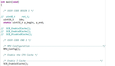

I'm using STM32H743 in my project.
If anyone knows how to disable D-cache, please help!
D-cache really interferes with my work - I'm tired of fighting it!
SCB_DisableDCache() - leads to nothing.

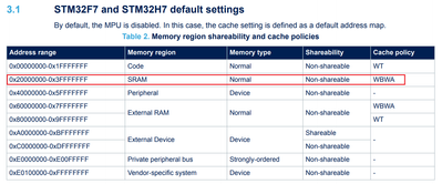

Second, Table 2 shows the default MPU memory region attributes for Cortex-M. So, this does not mean the cache is enabled by default but the region is cacheable. For example for the regions defined by default as device or strongly ordered and even you enable the cache using SCB_EnableXCache(), that region will not be cacheable.

Thank you for your participation. In my projects, I use Cube very sparingly - it often cannot help, but only loads the processor with unnecessary code. Unfortunately, the cache works by default - this is indicated in the documentation and in the debugger. I also observe this when processing arrays - the data does not appear immediately, but with a delay of several milliseconds - in my project this is critical. Flushing the cache by address or shared takes 50 microseconds - too much time and breaks the logic of the state machine. I will accept any advice on how to turn off the cache completely.
It would be very surprising if D-cache were enabled "by default" right after MCU startup.
Check this to know if the D-cache is on:
bool dcache_en = !!(SCB->CCR & (uint32_t)SCB_CCR_DC_Msk);
This is exactly what an4839 states - the cache is enabled by default
Unfortunately, your advice leads to HardFault.
At the very beginning when executing the MPU enable instruction.
void MPU_Config(void)
/* Disables the MPU */
LL_MPU_Disable();
/** Initializes and configures the Region and the memory to be protected
LL_MPU_ConfigRegion(LL_MPU_REGION_NUMBER0, 0x0, 0x30000000, LL_MPU_REGION_SIZE_128KB|LL_MPU_TEX_LEVEL0|LL_MPU_REGION_FULL_ACCESS|LL_MPU_INSTRUCTION_ACCESS_ENABLE|LL_MPU_ACCESS_SHAREABLE|LL_MPU_ACCESS_NOT_CACHEABLE|LL_MPU_ACCESS_NOT_BUFFERABLE);
LL_MPU_EnableRegion(LL_MPU_REGION_NUMBER0);
LL_MPU_ConfigRegion(LL_MPU_REGION_NUMBER1, 0x0, 0x38000000, LL_MPU_REGION_SIZE_64KB|LL_MPU_TEX_LEVEL0|LL_MPU_REGION_FULL_ACCESS|LL_MPU_INSTRUCTION_ACCESS_ENABLE|LL_MPU_ACCESS_SHAREABLE|LL_MPU_ACCESS_NOT_CACHEABLE|LL_MPU_ACCESS_NOT_BUFFERABLE);
LL_MPU_EnableRegion(LL_MPU_REGION_NUMBER1);
/* Enables the MPU */
LL_MPU_Enable(LL_MPU_CTRL_HFNMI_PRIVDEF_NONE);
when executing
follows HardFault.
Any help is welcome!
