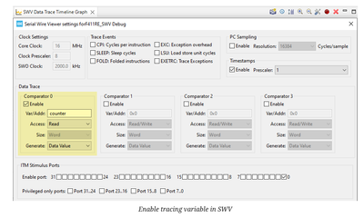

If you have SWO connected, you could try with SWD to catch the writing to the variable address of interest :
https://www.codeinsideout.com/blog/stm32/swv/#inspect-variables
My goal is to locate the code line number that modifies the global variable. So it's crucial to notify me as long as the variable is modified.
