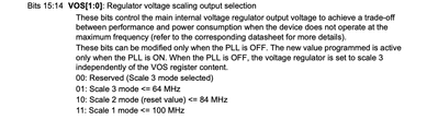

I'm working on an STM32F411 project using STM32CubeIDE (bare-metal, no HAL). I'm setting up a 1ms tick using SysTick_Config() and defining my own SysTick_Handler() to keep a millisecond counter. Here's the issue:
When I increment a static volatile global counter inside the handler using '++', the system crashes and ends up in Default_Handler. But strangely, if I assign a constant (e.g. millis = 123;), it works perfectly fine. Moreover, if I increment a local temp variable and increment millis, it'll take it just fine. Here's my code snippet. I'm not using the HAL library for this. Would you know why this would be? I'm using an STM32F411CE6 black pill.

Yup, hard fault, thanks for all your help. Seems like I had an issue with my clock setup - when I ran it at 75MHz, I think I was supposed to set the power control scaling for it to be able to go that high. The system defaults to scale 2, which supports only lower clock frequencies; anything greater would need this code to be put before the PLL setup.
The reference manual doesn't really state that you have to do this for 75MHz, it says only if you run less than 100MHz, but I guess I needed it.
 Enable interface clock and set the internal voltage regulator scale to scale 1
    RCC->APB1ENR |= RCC_APB1ENR_PWREN;
    PWR->CR |= PWR_CR_VOS;
