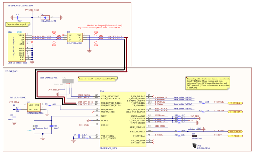

I have a curiosity to ask you. I have a NUCLEO-H743ZI2 without its micro USB connector (STLINK-V3E USB connector CN1).
I would like to know if it was possible to continue programming and debugging on the microcontroller integrated into the board using other ways.
Below I have reported some information that I was able to obtain from the manual. I saw that the signals of interest are 4: VBUS, GND, DM and DP. In the schematic below you can see that the DM and DM pins pass through a common mode filter and then arrive at pins PB14 and PB15 of the ST-LINK microcontroller. However, these pins are not accessible in any other way than through the CN1 connector. For this reason I imagined that there was no other way to continue programming the micro from a PC.
However, in the manual of this NUCLEO is said that there is a second way to program and debug the microcontroller. It is said that an external debugging tool can be connected to the CN5 MIPI-10 connector. I think it refers to the JTAG. Is this the only other solution? If this were the only alternative for programming and debugging, which tool should I use? Could you tell me?

Other SWD/JTAG pods, another ST-LINK?
S​TM32 Cube Programmer for USB, UART, CAN connectivity?
U​SART output of diagnostics and debug telemetry to terminal?

sorry for the poor quality of the picture, if necessary I can upload it with better quality
‎2022-02-16 12:51 AM
Couldn't you more directly attach the SWDIO, SWCLK, SWO and NRST​ pins of the Target MCU?
Or use ROM based System Loader functions and options via BOOT pin assertion?​

From your question is clean, that you dont understand how is and how work STLink.
Here you can see example board and two parts. Upper part is STLink programmer/debuger hw and can be all cut from board. And reply for your question you can programm main board bottom part with
- Other STLink board this can too debug
- System bootloader and all supported interfaces described in AN2606
