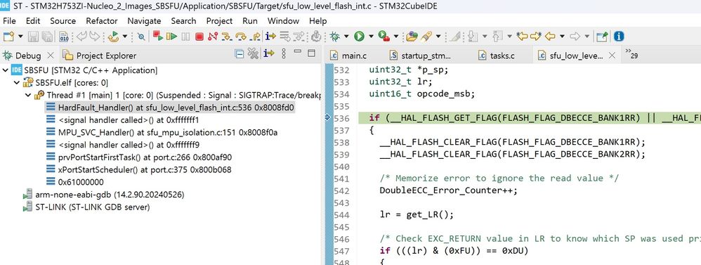

HardFault_Handler when call prvPortStartFirstTask() in STM32H753
EddiePark
I’m using NUCLEO STM32H753ZI.
I use ST ID: STM32cudeIDE
I have HardFault_Handler when call vTaskStart_Scheduler() using FreeRTOS
Could you please let me know how to resolve this issue?

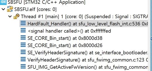

From the screenshot it looks like SFU software is involved, and the hard fault is expected. Have you tried to continue and let it recover?

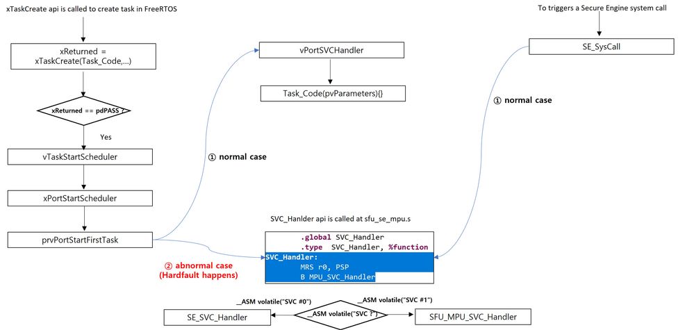

Hi.
I know what is problem for this issue.
But I don't know how to resolve this issue.
In case of normal, the api is called as the below.
vTaskStartScheduler -> xPortStartScheduler -> vPortSVCHandler

But hard fault happens when SVC_Handler api is called in sfu_se_mpu.s file

Pavel A.
Then there's some confusion between the SFU software you're using and FreeRTOS. I am not very familiar with SFU, perhaps it is not compatible with FreeRTOS, or assumes another flavor of FreeRTOS. In plain FreeRTOS the SVC handler vPortSVCHandler is invoked once, to start the scheduler. Here in sfu_se_mpu.s you have something different.
Hi.
In current, I use "STM32H753_SBSFU\Projects\NUCLEO-H753ZI" demo project.
I want to use xTaskCreate api from FreeRTOS.
so I apply freertos to demo project.
But vPortSVCHandler is not called in port.c of Freertos in when vTaskStartScheduler is called,
and hard fault happens "SVC_Hanlder" api is called in sfu_se_mpu.s
Is there any way to resolve this issue?
BRs.
Eddie Park
Yes this alone is easy to resolve: in FreeRTOS use some other unused interrupt vector instead of SVC. Not sure how this will interact with SFU.
