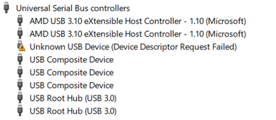

The device is shown as Unknown USB device (Device Descriptor Request Failed) in Device Manager
Pavel A.
So does your device show up with error as on the picture above, or as "Maple DFU"? The error shown above is not caused by any 3rd party driver, it is in the low level USB communication. Try a better cable and/or good USB 2.0 (not 3.x!) hub, better a powered one. If still shows up like above, your device (STM32) does not work.
The device shows as "Maple DFU" when I boot from the user flash with Arduino STM32 tools and with the error when I boot from the system DFU bootloader. One of the cables I tried was indeed causing problems, and I'll try a USB 2.x hub as my system has USB 3.x ports only. But why not USB 3.x?
