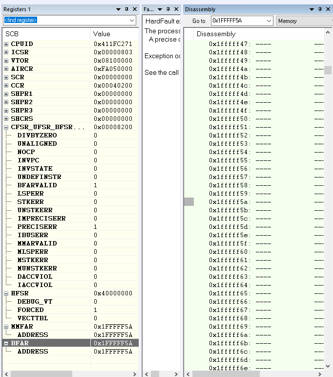

When I was trying to download the code to STM32H753VI using IAREmbeddedWorkbench, IARissued a warning to me.
Warning: There were warningsduringdownload, seeLogWindow
After pressing the OKbutton, I checked and found my code was held in HardFault_Handler.
This is allabout the IARwindowlogwindow.

I tried to find the cause, but I do not know the cause.
Why did this Hard Fault happen?
For reference, when downloading the code to STM32H753 Y, IAR did not issue these warnings, nor did the code be caught in HardFault_Handler.

Examine the SCB register values in the HardFault_Hander to determine the source of the fault. Although it sure looks like your program isn't downloading right, so maybe verify that first.
Ekim.1
As you said, I checked the SCD register and found that Hard Fault was occurring due to Bus Fault. So I followed BFAR’s address, but the area the address pointed to was the Reserved area.  Is there anything else I can do to solve the problem?0693W000000TUMeQAO.png

I think you need to find the source of the verify errors before anything else. Spend some time with the map file and the linker description file to determine what goes where and maybe why a section of flash bank 2 appears to be wrong.​

As you said, the data value was written down in the region where the Verify error occurred in the normal operating chip, but no data was written on the chip I am using now. But I don't know the cause.
Also, Is map file right to say .map file? I don't know what the linker description file is.Are you talking about the .icf file? And... What do you mean, speed time?
