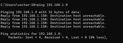

Hello ST Community,
I am currently working with the Nucleo H723ZG board and facing issues establishing a ping response using the LWIP stack. Despite following various examples and configurations, I have been unable to get it to respond to pings. Here are the details of my setup:
  • Development Environment: STM32CubeIDE V1.17  and STM32CubeMX V6.13.0
  • Configuration:
    • I have not used RTOS.
    • I configured the Ethernet settings according to package examples.
    • :C:\....\STM32Cube\Repository\STM32Cube_FW_H7_V1.12.1\Projects\NUCLEO-H723ZG\Applications\LwIP\LwIP_UDP_Echo_Server
    • I ensured that the Ethernet cable was connected properly and used a direct connection to my pc.
I have tried multiple versions of the H7 package ( 1.12.1 - 1.12.0 - 1.11.1 - 1.11.0 - 1.10.0 ) and tested various configurations without success. The ping command consistently results in "destination host unreachable."Could anyone provide insights or suggestions on what might be missing or misconfigured?

ethernetif_input(&gnetif);
sys_check_timeouts();
ressult:
My CPU clock is 520Mhz. I am sure the hardware has no problem because I can give a ping from the st package example.
But when I configure according that example it does not work.
.Thank you for your assistance!Best regards,

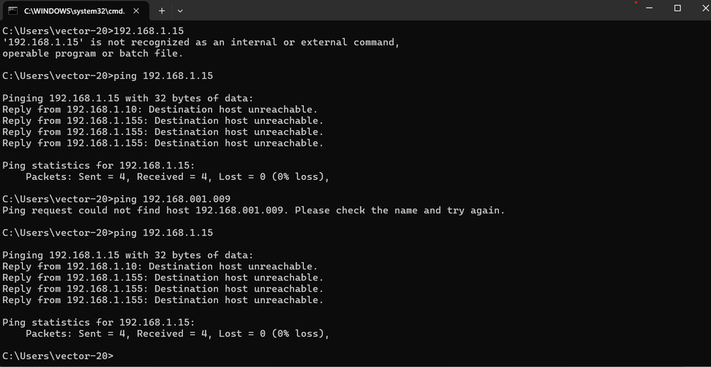

I am getting same errors.I didn't understand why it is happening.If anyone knows please let me know.
tuna1
I am getiing this error.Could you please help me?
I tried it but it is not working properly.
I figured out the problem.This code works for stm32h723zg microcontrollers.
