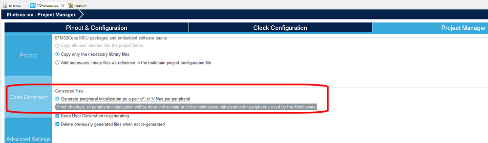

If you configure the project to generate separate .c & .h files for peripheral initialisation:
The extern declarations for the peripheral handles will be in the generated headers; eg,
