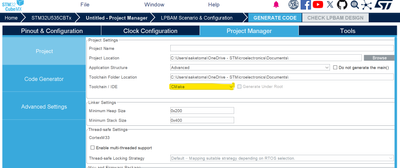

Hello @nicolas
Please use the latest version of STM32CubeMX.
Got to the tab Project Manager and under the option Toolchain/ IDE choose Cmake.
Saket_Om
Thanks for the answer. I wasn't able to convert the project because I was using STM32CubeIDE, now I can with STM32CubeMX.
But the generated CMake files are not using a hierarchical structure. So it doesn't help me for using CMake with the provided CMakeLists.txt found in stm32-mw-threadx and stm32-mw-filex.
