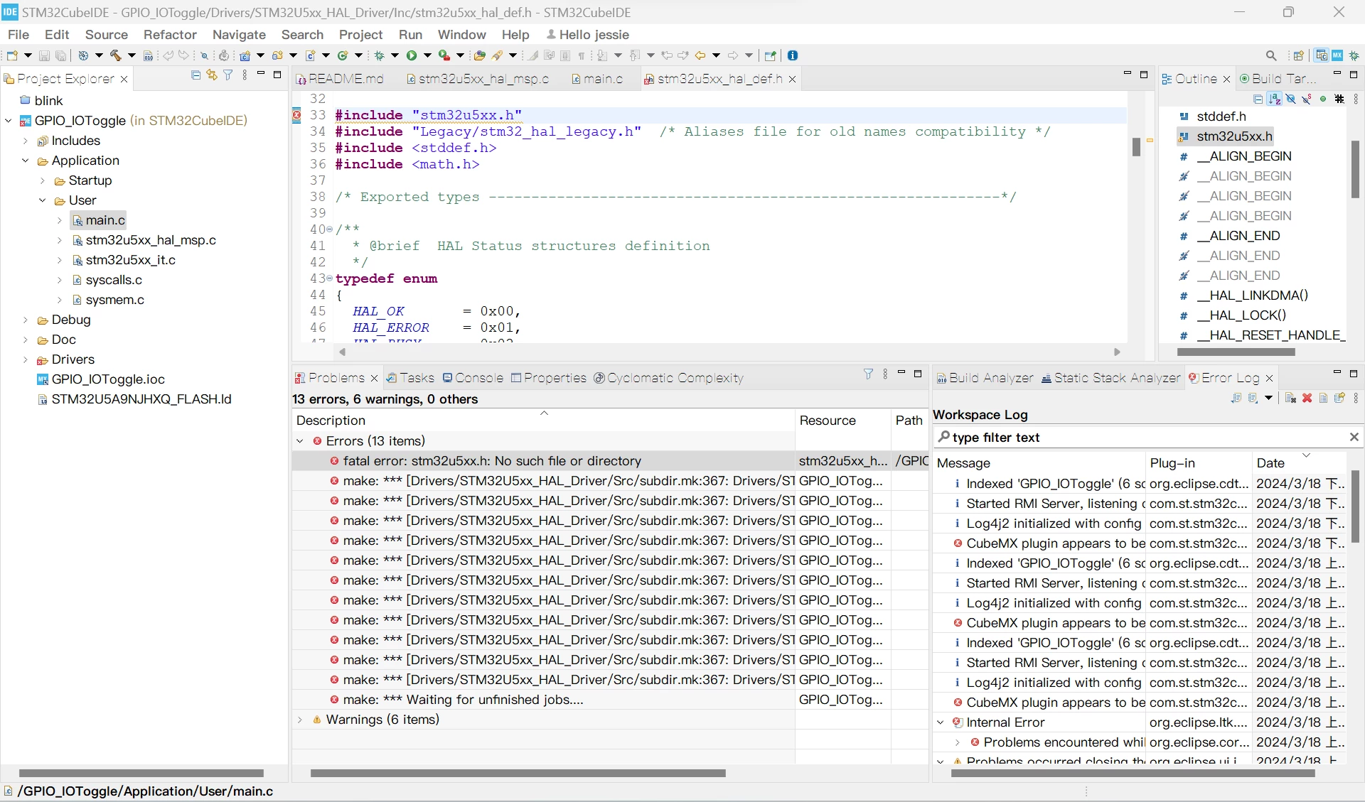

I am testing the development board STM32U5A9J-DK with THIS and trying to run the GPIO Toggle example program. But during the build process I get the error fatal error: stm32u5xx.h: No such file or directory.
I am using CubeIDE version 1.14.1.
How to fix this problem?

Try to clone this repository using the command.
git clone --recursive https://github.com/STMicroelectronics/STM32CubeU5.git

Hello @jessie_chiu and welcome to the ST Community :smiling_face_with_smiling_eyes:.
If you have downloaded the Cube Package using the Download as .Zip from Github you will may have such a problem. You need to download it using the Git Commands or the download as .Zip from our ST Website.
If you have done this, You should verify your paths.
Best Regards.

‎2024-03-18 1:50 AM
Hi, I'm glad to hear from you. I've re-downloaded the project using git and I'm still getting the same error, what else can I try?
‎2024-03-18 1:59 AM

‎2024-03-18 2:31 AM
If you download the package from here do you face the same issue?
‎2024-03-18 3:00 AM
I didn't try this specifically, but the git command worked for me, thanks for the answer!
