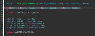

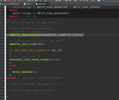

My understanding is that i need to modify the LAN8742 driver, which is default by Cubemx. When debugging I come across this part:
in the ethernetif.c file.
My question is, is it enough to rewrite the writeRegister, ReadRegister, Init, etc:
to use I2C instead of the MDIO?

This all is by heart. If I remember correctly, you're using I2C so you're not able to use the MDIO/MDC (same pins on IC, set by strapping pins). So you don't need to use the IO_WriteReg etc functions. Just be sure that the switch HW is functioning correctly. I think it is also mention in the forum post you're linking, that the 3th port is the RMII from the switch to the controller, you could just assume it to be always connected.
Check out the ethernet_link_check_state and the GetLinkState part. And adjust the LAN8742 driver.
See linked post, for example you could always return STATUS_100MBITS_FULLDUPLEX for the link state.
I think this was it on the driver side, if the HW is good ofcourse.
