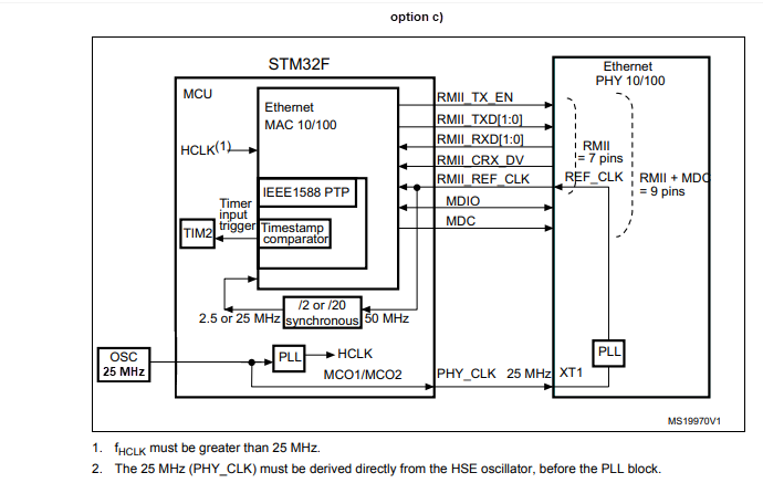

Heyho,
until now I only used STM32 with the LAN8742, in a few weeks I'll get my 2nd custom board, but this time with the "dual" PHY KSZ8863RLL.
It's connected via RMII, for setup MDIO (and optionally I2C for the registers not accessible via MDIO).
Are there any known issues or "pitfalls" with this PHY?

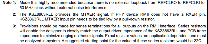

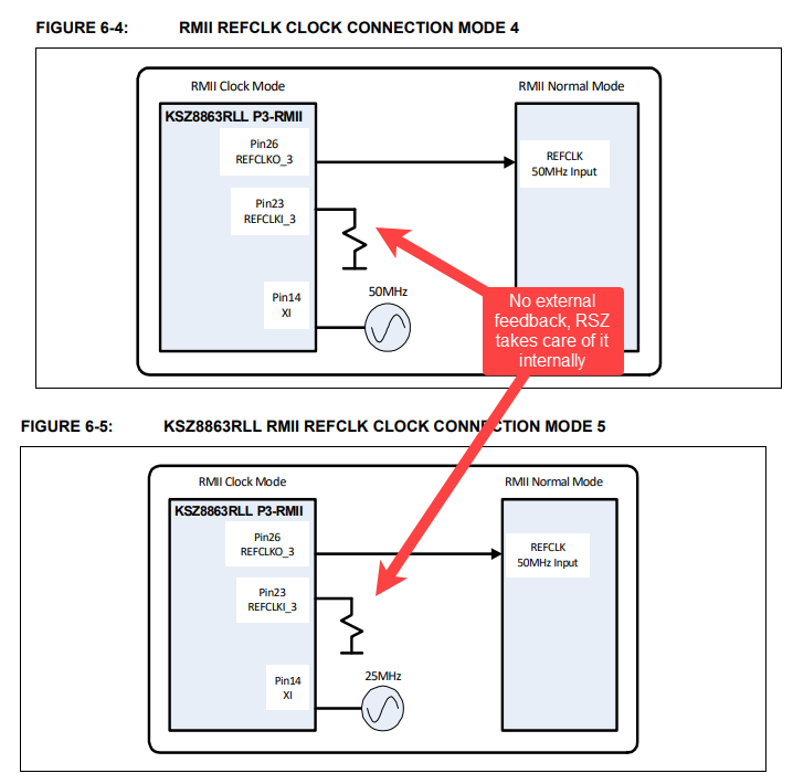

I have my board with STM32H733, KSZ8863RLL, LAN9512 up and running.
Here's the most important advice:
a) use internal RMII clock
b) use I2C (or SPI) - which is a must for a)
MDIO only allows access to a few basic registers (as already mentioned by Pavel), but to enable internal RMII clock (recommended by datasheet), a register only accessible via I2C / SPI must be written. (Bad design IMO).
