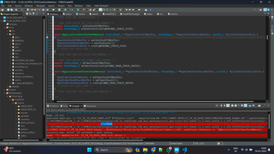

This Error occures when compling code
13:39:46 **** Incremental Build of configuration Debug for project 15_04_24_RTOS_TEST ****
make -j4 all
arm-none-eabi-gcc -o "15_04_24_RTOS_TEST.elf" @"objects.list"   -mcpu=cortex-m4 -T"D:\STM32 RTOS\15_04_24_RTOS_TEST\STM32F411CEUX_FLASH.ld" --specs=nosys.specs -Wl,-Map="15_04_24_RTOS_TEST.map" -Wl,--gc-sections -static --specs=nano.specs -mfpu=fpv4-sp-d16 -mfloat-abi=hard -mthumb -u _printf_float -u _scanf_float -Wl,--start-group -lc -lm -Wl,--end-group
C:/ST/STM32CubeIDE_1.14.1/STM32CubeIDE/plugins/com.st.stm32cube.ide.mcu.externaltools.gnu-tools-for-stm32.11.3.rel1.win32_1.1.100.202309141235/tools/bin/../lib/gcc/arm-none-eabi/11.3.1/../../../../arm-none-eabi/bin/ld.exe: ./Core/Src/main.o: in function `vApplicationGetIdleTaskMemory':
D:/STM32 RTOS/15_04_24_RTOS_TEST/Debug/../Core/Src/freertos.c:123: multiple definition of `vApplicationGetIdleTaskMemory'; ./Core/Src/freertos.o:D:/STM32 RTOS/15_04_24_RTOS_TEST/Debug/../Core/Src/freertos.c:123: first defined here
C:/ST/STM32CubeIDE_1.14.1/STM32CubeIDE/plugins/com.st.stm32cube.ide.mcu.externaltools.gnu-tools-for-stm32.11.3.rel1.win32_1.1.100.202309141235/tools/bin/../lib/gcc/arm-none-eabi/11.3.1/../../../../arm-none-eabi/bin/ld.exe: ./Middlewares/Third_Party/FreeRTOS/Source/timers.o: in function `xTimerCreateTimerTask':
D:/STM32 RTOS/15_04_24_RTOS_TEST/Debug/../Middlewares/Third_Party/FreeRTOS/Source/timers.c:245: undefined reference to `vApplicationGetTimerTaskMemory'
collect2.exe: error: ld returned 1 exit status
make: *** [makefile:68: 15_04_24_RTOS_TEST.elf] Error 1
"make -j4 all" terminated with exit code 2. Build might be incomplete.
13:39:47 Build Failed. 3 errors, 0 warnings. (took 709ms)
freertos.c
void vApplicationGetIdleTaskMemory( StaticTask_t **ppxIdleTaskTCBBuffer, StackType_t **ppxIdleTaskStackBuffer, uint32_t *pulIdleTaskStackSize )
  *ppxIdleTaskTCBBuffer = &xIdleTaskTCBBuffer;
  *ppxIdleTaskStackBuffer = &xIdleStack[0];
  *pulIdleTaskStackSize = configMINIMAL_STACK_SIZE;
  /* place for user code */

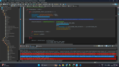

 timers.c
if( xTimerQueue != NULL )
		#if( configSUPPORT_STATIC_ALLOCATION == 1 )
			StaticTask_t *pxTimerTaskTCBBuffer = NULL;
			StackType_t *pxTimerTaskStackBuffer = NULL;
			uint32_t ulTimerTaskStackSize;
		vApplicationGetTimerTaskMemory( &pxTimerTaskTCBBuffer, &pxTimerTaskStackBuffer, &ulTimerTaskStackSize );
			xTimerTaskHandle = xTaskCreateStatic(	prvTimerTask,
													configTIMER_SERVICE_TASK_NAME,
													ulTimerTaskStackSize,
													NULL,
													( ( UBaseType_t ) configTIMER_TASK_PRIORITY ) | portPRIVILEGE_BIT,
													pxTimerTaskTCBBuffer );
			if( xTimerTaskHandle != NULL )
				xReturn = pdPASS;
