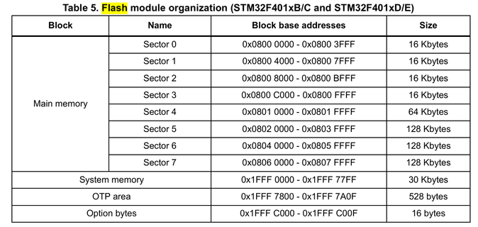

The eeprom emulation in my simple trial sofware is working fine. The code is quite small.
I tried to use this software inside a more complex program, larger than 64K, and the system hangs.
From what I have understood only the first 16K are available for program with the suggested setup.
It is possile to have a setup for eeprom that allows to use more flash program memory?
Your defines seems ok , but too is required linker file changes for spare this space.
MEMORY
  FLASH0 (rx)      : ORIGIN = 0x08000000, LENGTH = 16K	/* FL0 only isr */
  CCMRAM    (xrw)    : ORIGIN = 0x10000000,   LENGTH = 64K
  RAM    (xrw)    : ORIGIN = 0x20000000,   LENGTH = 320K
  FLASH    (rx)    : ORIGIN = 0x8010000,   LENGTH = 1984K /* reserve EEPROM sec 1 2 3 used only 2 3*/

The project is for stm32f401re and includes SD card and CDC. Using the examples I was able to run the eeprom emulation in a small sample project. I would now undestand how to run it in alarger project (more than 64K).
I was playing with the configuration file with bad results (target not detected..). Can someone help me to understand what to do with programs larger than 16K? How can I  configure to have the program in separate pages?
For emulation is requiredd knowledge about flash sectors for F4
your code for emulate require arange into little sectors, or you waste big when not used, your choice your job.

I used sectors 2 and 3 (16K) as in the example  and in large program it is not working:
/* EEPROM start address in Flash */
#define EEPROM_START_ADDRESS ((uint32_t)0x08008000) /* EEPROM emulation start address:
from sector2 : after 16KByte of used
Flash memory */
/* Pages 0 and 1 base and end addresses */
#define PAGE0_BASE_ADDRESS ((uint32_t)(EEPROM_START_ADDRESS + 0x0000))
#define PAGE0_END_ADDRESS ((uint32_t)(EEPROM_START_ADDRESS + (PAGE_SIZE - 1)))
#define PAGE0_ID FLASH_SECTOR_2
#define PAGE1_BASE_ADDRESS ((uint32_t)(EEPROM_START_ADDRESS + 0x4000))
#define PAGE1_END_ADDRESS ((uint32_t)(EEPROM_START_ADDRESS + (2 * PAGE_SIZE - 1))-1)
#define PAGE1_ID FLASH_SECTOR_3

Note that X-CUBE-EEPROM is not for STM32F4 - you need STSW-STM32066 (AN3969)instead:
https://community.st.com/t5/stm32-mcus-embedded-software/x-cube-eeprom-not-for-stm32f0/m-p/684685/highlight/true#M48486:~:text=STM32F4%20%2D%20see%20AN3969%20instead%3B
But you still have to choose your Flash pages.

OldSTMan
Thanks , the last hint solved all my problems !
