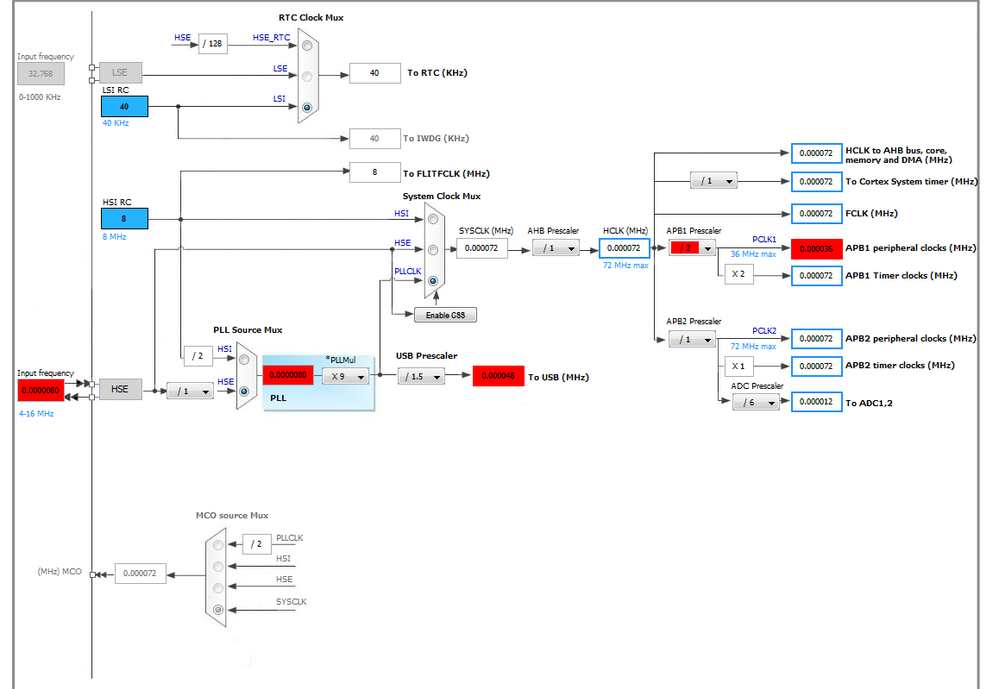

Hi, I'm using Cube v4.22 as Eclipse (version 4.5.2) plugin. I've encountered a problem with clock configuration - when I write a frequency in the Input Frequency field, Cube automatically divides it by million. This generally wouldn't be a big deal (putting value in Hz instead of MHz as indicated by the comment), but when I later touch any other setting or generate code, the value divides by another million again - producing wrong values in all the fields. I don't know if it actually affects the generated code, but surely it is annoying.
Screenshot of my Cube after I have written 8000000, enter and then started changing some ADC divider:
If I keep pressing enter while in Input Frequency window, it keeps dividing whatever is in there by one milion at a time.

STM32F103C8. The same happens when I try STM32F072V8. I think this isn't associated with any specific uC, it is a problem somewhere in Cube and/or Eclipse, as I don't even get to generating the code.
When I write 8 in the field and press enter or click anywhere outside the box, it automatically divides by 1000000 and leaves same screen as I attached.
If I enter 8 with as many zeroes as needed, I get to generate code with correct value visible on screen and the code works correctly, I'm aiming only the necessity of writing a number with many zeroes to get the correct, lone 8 in the field.- Mark as New

Hi, I've manually downloaded the latest version of Cube (4.23). LSE was bugged as soon as chosen, HSE was correctly set at 8MHz until I tried to write the value manually. I didn't update Eclipse.
I'm attaching the .ioc file.BTW. If only 32768Hz quartz is accepted as LSE, maybe the option to write arbitrary values in the Input Frequency for LSE is not needed?

Over a year passed and this annoying bug still exists. I've downloaded newest SW4STM32 with newest Cube (and checked for updates) and again I can see this:
I've tried manually changing the value in .ioc file to 32768, 32.768 - whatever, it still divides it and then constantly bothers me with message that my clock system is #$%^ up.
Now with old cube I was able to work around the problem by putting 32768000, which then automatically divided into correct value. Currently I am unable to write into LSE Input Frequency (so this definitely is not my fault, that there is wrong value in that field!)
I tried to overcome it by editing the .ioc file, but whatever I write (32768, 32768000, 32.768) Cube still divides this value by 1000000 whenever I open Clock Configuration panel.
I even tried building a project on H743ZI Nucleo board using the option of having everything predefined to the board. And guess what - from the start the Clock Configuration was messed up by LSE input frequency field.
BTW. This "Save Project" popup should definitely appear less frequently, it's annoying. And user can't change it at all. User preferences box is empty.
So now, that the problem is definitely not caused by me using outdated software, why is this out-of-nowhere LSE input division still here?!

Ha! As soon as I modified .ioc file by myself and wrote
RCC.LSE_VALUE=32768000
RCC.RTCFreq_Value=32768000
saved it, opened SW4STM32, generated code without going into Clock Configuration I suddenly saw my code working properly. This incorrect value seems to block SystemClock_Config();, as my previously not working code suddenly started working flawlessly even though I changed nothing but that.
So, long story short, if you want to use the easy to use code generator, you have to set your MCU and then save it, close program, open .ioc file manually and then change two specific values in it. Later you have to close the .ioc file, open SW4STM32, open Cube, DON'T YOU DARE GO INTO CLOCK CONFIGURATION and press Generate Code. Phew, that's intuitive!
