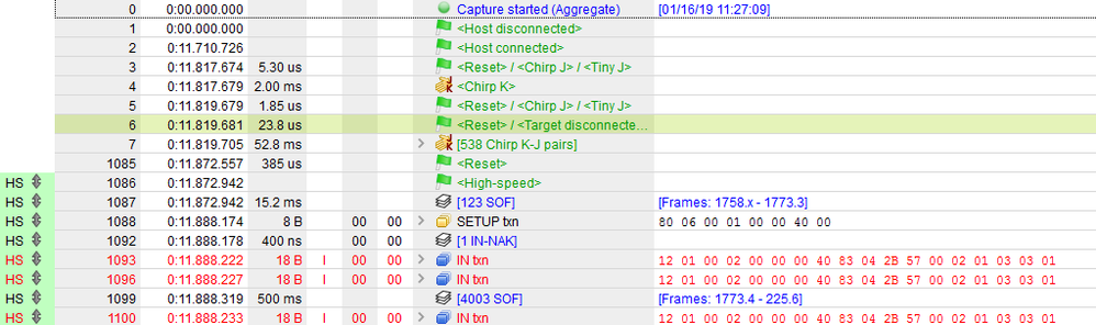

Been searching, but I can find anything. Most responses refer to the fact that you need the ULPI PHY. I have a USB330 ULPI board plugged. I configured the new pins. If I recall one was shared with the accelerometer so I switched the mouse to be GPIO buttons rather the accelerometer. I did USBD_Init(&hUSBDDevice, &HID_Desc, DEVICE_HS); instead of DEVICE_FS. Note if I use DEVICE_FS the mouse still works. I modified USBD_LL_Init to add:

It is seen by the host and enumeration is started, but fails. My Beagle SUB 480 protocol analyzer shows a response, but I think it is at the wrong time.

It may be a little hard to read, but I think my issues is the first Setup packet is naked. Anyone?

Turns out I did everything right in FW. There was a pin conflict in HW. Thanks for your help.
