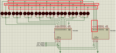

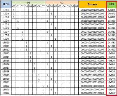

Friends, which algorithm do you use to control the LEDs in this structure? I need your ideas. I have prepared a table of the LEDs' turn on order.

Not sure what do you mean by
Define a lookup table where you put your pattern.
const uint16_t tab[] = {0x8080, 0x8040, ....};
Then use this table to shift out the bits to the shift register.
XooMAuthor
November 20, 2024
Have you examined the electronic circuit?
for example, what should be the algorithm to turn on led1 led2 led3 and led4?
Because when led1 led2 led3 is active, the (2nd) 74hc4094 integrated circuit on the right has to give cathode information to all leds.
If you turn on led4 while led1 led2 led3 is on, how will you ensure that led5 and led6 remain off?
That's what the table you posted tells you - it tells you what values to write to get each LED illuminated.

Lead III
November 20, 2024
A lot has already been said in this topic. I'd like to ask a few questions:
  1. What is the purpose of this project? (What are the requirements?)
  2. What are the LEDs connected to? 7 segment displays?
  3. Does each LED have its own current limiting resistor or are those shared by a group of 3?
  4. what strobe rate do you want?
  5. Are glitches in strobing allowed or do you not want LEDS to glitch momentarily?
  6. I see data of second shift unconnected that is not good. How do you intend to control that?
The LED's need to be controlled via strobing if you want to allow all LEDs to be controlled individually (due to persistence of vision at sufficient strobing rates). Otherwise you cannot get all combinations working.
In this case you have 8 groups of 3 (or 3 groups of 8 depending on how you see it)
So I would implement the algorithm the following way:

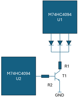

@XooM show the full schematic - transistor, all resistors, etc - for one group of three LEDs
Or confirm if @mƎALLEm guessed correctly with this:
Is there really only one R1 per group of 3, or is there a separate series resistor for each LED ?

@XooM What is driving you to use this board - which, apparently, has inadequate documentation and no support??
XooMAuthor
November 20, 2024
Friends, I will give you the document you want in a moment, but I do not understand how this forum works. In the country where I speak my own language, we can understand what we mean very quickly without giving too much detail. Here, people either have poor electronics knowledge or want to know everything.
I just made a simplified drawing to ask for help from the algorithm.
The missing parts are not relevant to the question I asked.
I assumed that everything was complete and wanted to talk about the algorithm. There is no deficiency or error in the design of the circuit. The circuit is an actively working circuit.
Since every programmer has a different perspective, I asked to learn your perspective on the event.
I will explain the missing parts of the circuit and my own coding in a way you can understand.
I will share it in 30 minutes.
