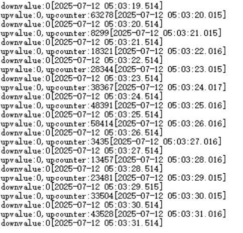

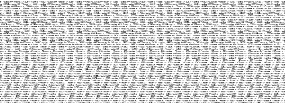

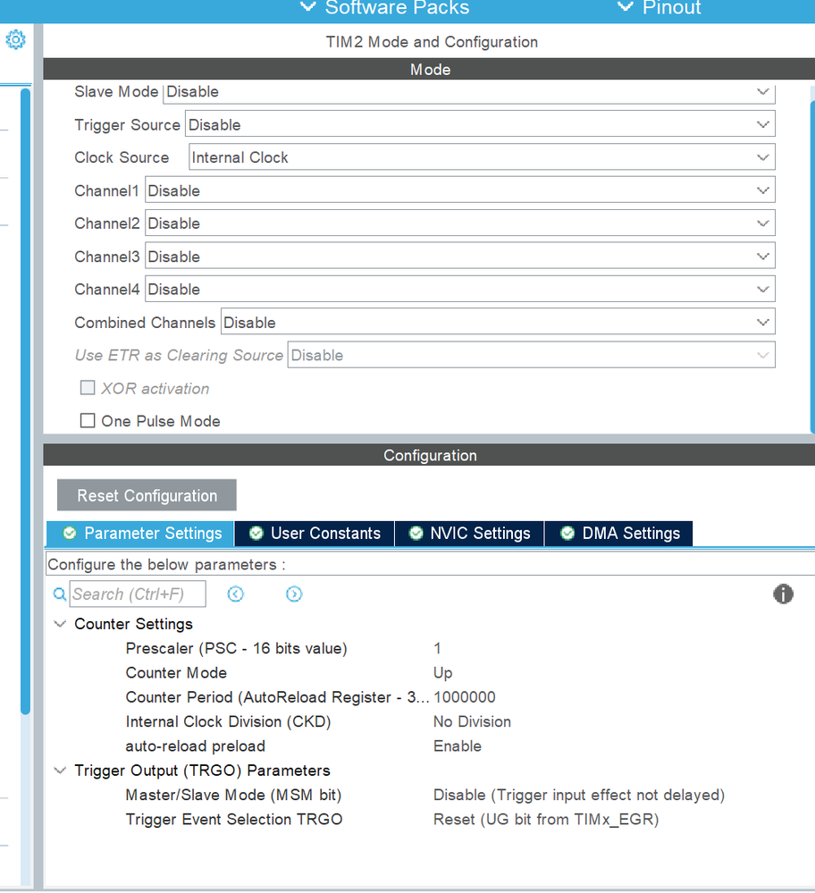

tim2 of stm32h753: 32-bit counter can only count up to 65,536.

Definitely 32-bit, inspect registers with debugger.

Show the generated code, the configuration screens aren't helping me understand the source of the problem.
Make sure you're not reading the TIM2->CNT value into a smaller variable and truncating.

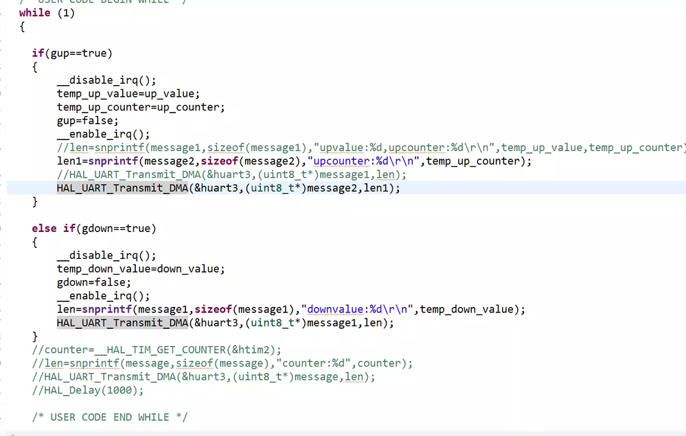

void HAL_TIM_IC_CaptureCallback(TIM_HandleTypeDef *htim)
    if(htim->Instance==TIM2)
      if(htim->Channel==HAL_TIM_ACTIVE_CHANNEL_1
        up_value=HAL_TIM_ReadCapturedValue(htim,HAL_TIM_ACTIVE_CHANNEL_1);
        up_counter=__HAL_TIM_GET_COUNTER(htim);
This is the latest test for capturing peripherals, with no captured values at all
In the test of capturing peripherals, both upvalue and downvalue should have been captured, but the corresponding values were not obtained at all, they were both 0. That is to say, there is no corresponding hardware for capturing

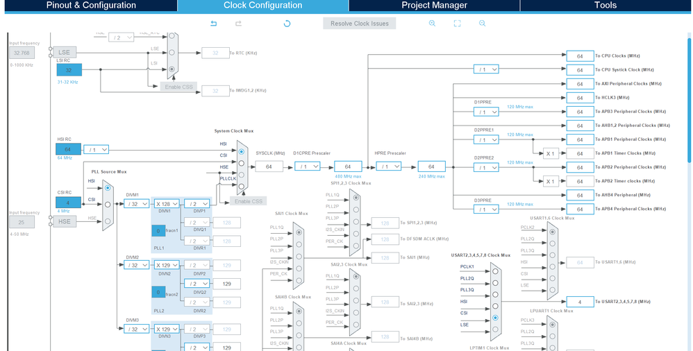

On a microcontroller with a frequency of 480M, when running this code, the interrupt can only run up to 70K
Clock-tree setting shows: cpu running at 64 MHz. Why this ?
Seems you run the 480M cpu at 64M . right ?
Show the variable definitions
super screens and code parts, but stil dont show if your up_value and other is realy
volatile uint32_t up_value...
