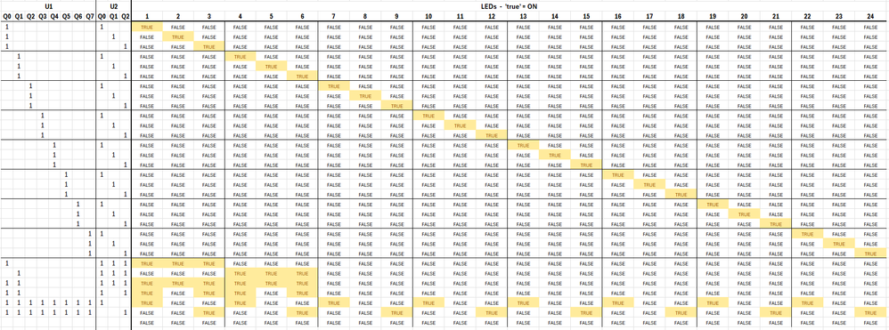

I made a spreadsheet to investigate possible combinations of LEDs:
You image in question make more problem as info. Missed transistors is then on right side and left 8bit is connected to LED direct. Then your code need
array uint16_t LEDs[3] = { 0x0080, 0x0040, 0x0020 };
for set leds 0-7 manage
LEDs[0] |= (8bitled) <<8 ; you can manage this all 8 led
for 8-15
LEDs[1] |=(8bitled) <<8 ;
then your led manager timer every 5ms show one of this
timer 5ms code
static uint8_t qoutposition=0;
HC4094write(LEDs[qoutposition]);
qoutposition++;
if(qoutposition==3) qoutposition=0;

No your code isnt ok , because led light if more as one input active only some us . if Only one input is active led light relative ok only one data is send to one led and repeat in time input is selected.
But i mean your real situation not guarantie only one input selected ?
TRY in timer only my code and set values in main based for all 24 leds.
Too your code send into 595 LSB first, but normal logic is MSB first. Then maybe try change
if(data & (1<<(15-i)))
and swap bytes in array
uint16_t LEDs[3] = { 0x0100, 0x0200, 0x0400 };
for set leds then
LEDs[0]|=8leds;...
