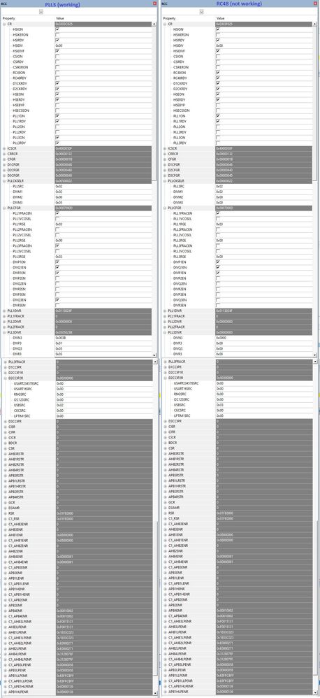

I'm developing a USB-Host application (MSC / Fullspeed) with the STM32H743 µC (using STM32H743I-EVAL2 Board)
The application works fine when using PLL3Q as clocksource.
But when I use PLL1Q or RC48 as clocksource the USB "Core soft reset" timed out:
OTG->GRSTCTL |= USB_OTG_GRSTCTL_CSRST; // Core soft reset
// Wait Core reset to finish, max 100 ms
tout_ms = 100U;
while ((OTG->GRSTCTL & USB_OTG_GRSTCTL_CSRST) != 0U) {
  if (tout_ms == 0U) {
    return ARM_DRIVER_ERROR_TIMEOUT;
  tout_ms--;
  HAL_Delay(1U);
HAL_Delay(1U);
I mapped RC48 to MCO1 to check if there is an 48MHz output and it is.
I checked the RCC/USB registers but couldn't find anything suspicious.
Does anyone has an idea what's wrong here?

HSI48 should be calibrated to some external source with the CRS peipheral, either to LSE or a SOF signal coming from another host. CRS is not running (APB1HENR = 0), LSE is not running (BDCR = 0), and there is no incoming SOF because you are the host.
This should not prevent an USB core reset though, but I am not exactly sure what an unconfigured CRS would do to HSI48. Anyway, not a healthy configuration.

Can you post the contents of all RCC registers for the working and non-working cases?
sure, here is a picture, mapping all changed RCC registers just before the soft reset should occur.
On the left the working PLL3 configuration and on the right the non working RC48 configuration.

waclawek.jan
And what if you remove the timeout, does the reset hang forever?
PBull
You're right! After a complete power cycle, the USB with HSI48 worked for approx. 5 minutes, then the error came back.
When I think about it, it should be clear that the accuracy cannot be very high, because it's just an RC oscillator and USB has tight timing constraints.
Without calibration it's more like an adventure.
And the USB-PLL1 doesn't work because of a configuration mismatch (24 Mhz instead of 25Mhz HSE).
Thanks for the support!
