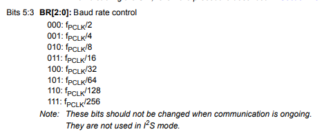

could you tell me please the real clock value set in this example,
\STM32Cube\Repository\STM32Cube_FW_F4_V1.25.1\Projects\STM32F429I-Discovery\Examples\SPI\SPI_FullDuplex_ComDMA
The clock frequency between master and slave must be equal, does the frequency communication is imposed by the master since they have to be the same?

‎2020-10-08 8:21 AM
It depends on the DSP used.
You can configure the baude rate of CR register (calculate APB1/baud rate configured, APB2/baud rate).
In fact, the prescaler define the SPI BUS clock.

‎2020-10-07 11:04 AM
Hello @NSemrHomeInit​ ,
The clock is imposed by the master.
What do you mean by real clock w the baudrate is configured in SPIx_CR1 register ?
Imen

‎2020-10-08 2:18 AM
Hello Imen,
I am trying an SPI communication between the two boards, DSP and STM32F.
Do i have to configure the clock of the DSP the same as the SMT32F?
I have two microcontroller, both are clock configured, but in the end, the master clock will be considered as a clock for the spi bus.
‎2020-10-08 2:35 AM
The master supplies the only clock and the transmit/receive is symmetrical, but can occur on different clock edges.​
‎2020-10-08 8:21 AM
