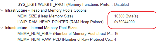

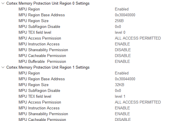

I have read quite a few threads about ethernet on the H7, along with several internet posts. Part of me wonders if I should even try... But I am.
I've followed this guide:
https://community.st.com/s/article/How-to-create-project-for-STM32H7-with-Ethernet-and-LwIP-stack-working?t=1679361727348
As well as this guide:
https://github.com/AnielShri/STM32H745_Ethernet/blob/master/Documentation/lwip_nortos.md
They are similar, with some slight differences with the MPU cache settings.
For me, the first post results in a hard fault. But with the second, I am able to boot.
While I would eventually like to get to RTOS, at the moment I'm just trying to implement this using LWIP.
My first test is just basic ICMP - which doesn't work. That is, until I comment out this line:
SCB_EnableDCache();
So, of course, that implies something with the data cache, and memory locations.
So, my settings looks like these:
0693W00000aJMqQQAW.pngLWIP settings:
I've added the following to the linker script:
  /* Modification start */
  .lwip_sec (NOLOAD) : {
    . = ABSOLUTE(0x30040000);
    *(.RxDecripSection)
    . = ABSOLUTE(0x30040060);
    *(.TxDecripSection)
    . = ABSOLUTE(0x30040200);
    *(.RxArraySection)
  } >RAM_D2
Sometimes, I get this error upon each ICMP packet that is received:
 Assertion "pbuf_free: p->ref > 0" failed at line 753 in ../Middlewares/Third_Party/LwIP/src/core/pbuf.c
Again, it goes away when I disable the dcache. I'm not sure what else to try. I must have something not quite right. Thanks.
>SCB_EnableDCache();
Of course it does. But this is a bit complicated. So keep reading the forum posts, especially by @Piranha​  who made several valuable digests.
Also look at most recent ST examples for H7 here.
Hold your impulse to generate projects with CubeMX/IDE until you have at least one ready example (for some eval board) working more or less.
Also note that recently ST ​is moving from LwIP and FreeRTOS to Microsoft's offering: AzureRTOS (ThreadX, NetX etc.), if this sounds good to you, research that direction.

https://community.st.com/s/question/0D53W00001Z9K9TSAV/maintaining-cpu-data-cache-coherence-for-dma-buffers
https://community.st.com/s/question/0D50X0000BOtfhnSQB/how-to-make-ethernet-and-lwip-working-on-stm32
