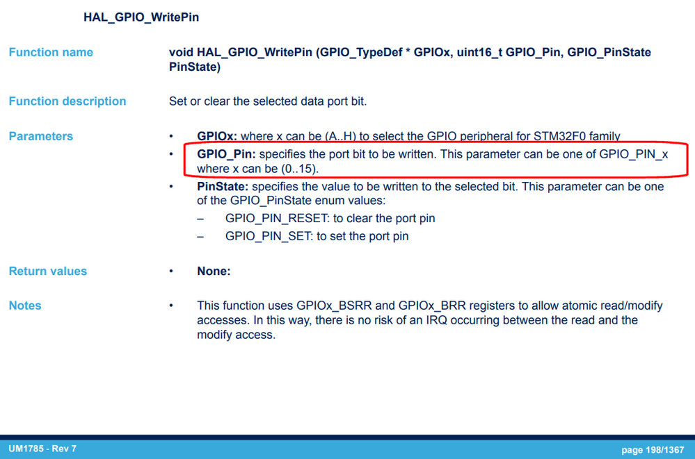

But the documentation:
Is not at all clear that GPIO_Pin is a bitmask.
In this case, neither of them, LL_GPIO_PIN_xx definitions contain multiple (three?) fields, neither of them is pin number and only one of them is the pin mask.
Nonetheless, LL_GPIO_Init() as it is now *is* written with the multiple-pins-at-once in mind; however, I am hesitant to rely on that once there's not a single iota hinting toward this option in the documentation I know of.

But, indeed, this still doesn't guarantee that any particular function/macro taking them as a parameter will actually work with a multi-pin pattern.
So, indeed, this documentation needs to be clarified.
Throughout.

> Especially given the final "ALL" definition
The only purpose of the "ALL" is to be used in the "checker" macro, where it verifies that at least one of those 3 fields is nonzero and all other bits not occupied by those fileds are zero.
The HAL_GPIO_WritePin() you've quoted above *is* different from the initialization and it may indeed require only one pin at a time (not going to dig into that either).
