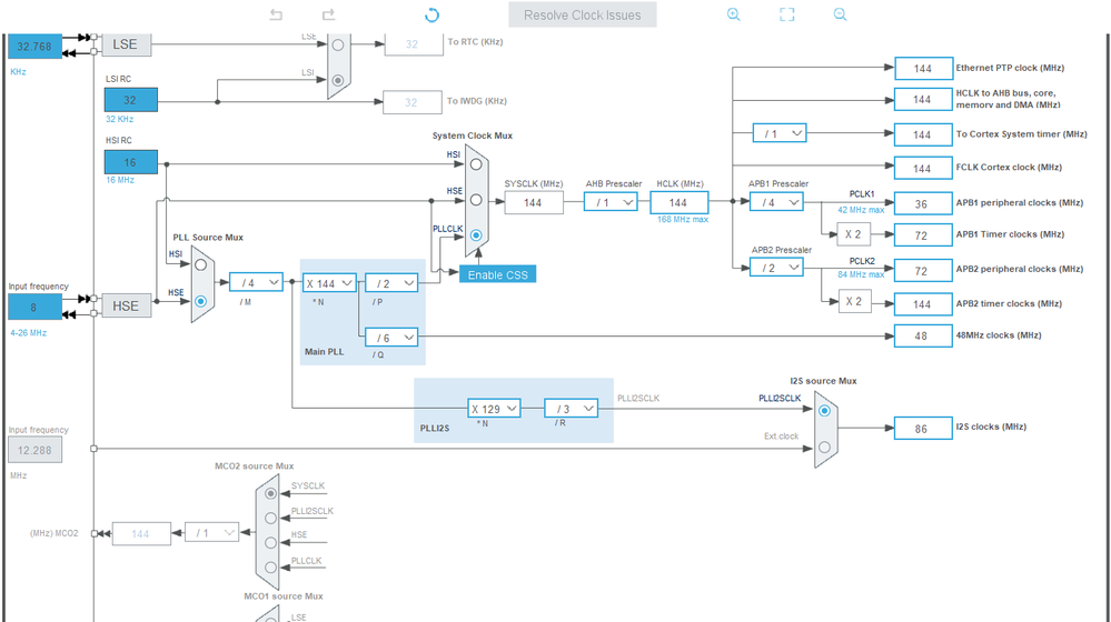

I am working on a USB Audio streaming project using an STM32F407 Discovery board. I am using the USB Device (Audio Class) and I2S3 to output audio to the onboard CS43L22 DAC (I plan to move to MAX98357 later).
Problem:
The PC recognizes the board as an "STM32 Audio Class" device. However, when I play audio, there is a very high level of noise/distortion. While I can faintly hear the music behind the noise, the output is dominated by a harsh "buzzing" or "crackling" sound.
Any guidance or suggestions would be greatly appreciated!
I2S Parameter SettingsI2S Parameter SettingsClock configurationClock configuration

I'm not at all an expert with USB and audio class devices.
However, have you considered this is a data format issue ?
I would record a short sample with a PC audio editor (my favorite is Audacity), and review the audio data.
Perhaps you can easily modify your F407 application to transmit a sine wave, and check this audio data on PC side.
