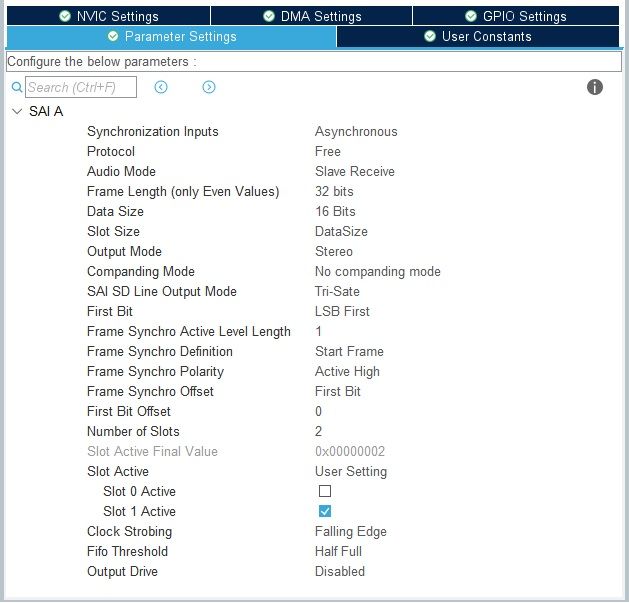

‎2023-02-08 4:17 AM
Thank you for your response.
I am setting from IOC file by referring to SAI_AudioPlayback code.
​The following is the configuration of the ioc file
​The following is the code that performed [generate code] from the ioc file.
hsai_BlockA4.Instance = SAI4_Block_A;
hsai_BlockA4.Init.Protocol = SAI_FREE_PROTOCOL;
hsai_BlockA4.Init.AudioMode = SAI_MODESLAVE_RX;
hsai_BlockA4.Init.DataSize = SAI_DATASIZE_16;
hsai_BlockA4.Init.FirstBit = SAI_FIRSTBIT_LSB;
hsai_BlockA4.Init.ClockStrobing = SAI_CLOCKSTROBING_FALLINGEDGE;
hsai_BlockA4.Init.Synchro = SAI_ASYNCHRONOUS;
hsai_BlockA4.Init.OutputDrive = SAI_OUTPUTDRIVE_DISABLE;
hsai_BlockA4.Init.FIFOThreshold = SAI_FIFOTHRESHOLD_HF;
hsai_BlockA4.Init.SynchroExt = SAI_SYNCEXT_DISABLE;
hsai_BlockA4.Init.MonoStereoMode = SAI_STEREOMODE;
hsai_BlockA4.Init.CompandingMode = SAI_NOCOMPANDING;
hsai_BlockA4.Init.TriState = SAI_OUTPUT_RELEASED;
hsai_BlockA4.Init.PdmInit.Activation = DISABLE;
hsai_BlockA4.Init.PdmInit.MicPairsNbr = 1;
hsai_BlockA4.Init.PdmInit.ClockEnable = SAI_PDM_CLOCK1_ENABLE;
hsai_BlockA4.FrameInit.FrameLength = 32;
hsai_BlockA4.FrameInit.ActiveFrameLength = 1;
hsai_BlockA4.FrameInit.FSDefinition = SAI_FS_STARTFRAME;
hsai_BlockA4.FrameInit.FSPolarity = SAI_FS_ACTIVE_HIGH;
hsai_BlockA4.FrameInit.FSOffset = SAI_FS_FIRSTBIT;
hsai_BlockA4.SlotInit.FirstBitOffset = 0;
hsai_BlockA4.SlotInit.SlotSize = SAI_SLOTSIZE_DATASIZE;
hsai_BlockA4.SlotInit.SlotNumber = 2;
hsai_BlockA4.SlotInit.SlotActive = 0x00000002;
if (HAL_SAI_Init(&hsai_BlockA4) != HAL_OK)
Error_Handler();
​I don't know where [hsai_BlockA4.Init.PdmInit.] in the code above is in the IOC file.
That part is different from the part in the SAI_AudioPlayback code, but I don't know where to modify it in the ioc file.
Please let me know where to fix.
