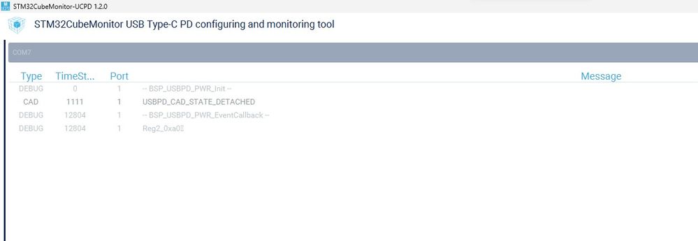

The following is the trace that occurs with my project which followed this wiki.
If I load the src1m1 project from x-cube-tcpp by selecting the ioc file in STM32CubeIDE, building it, and running it, I do not get anything in the trace.0693W00000YAOXKQA5.jpg
During the trace above I did connect a USB-C capable device.

Nicolas P.
Hello @AChin.3​
Just did the test with a Nucleo STM32G491, with binary from github. (Even if the binary is for a STM32G474...)
Here is what I get in the trace windows of STM32CubeMonitor-UCPD, on startup :
