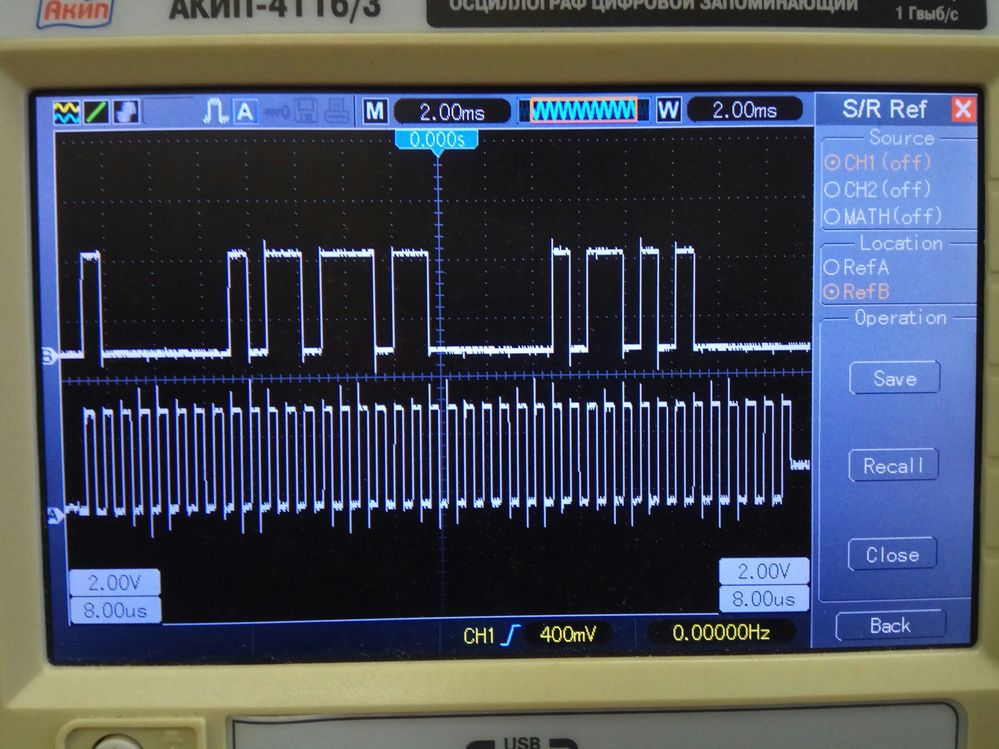

Posted on September 25, 2017 at 15:27
I'm trying to use two AD7690 (18-bit ADC)
http://www.analog.com/media/en/technical-documentation/data-sheets/AD7690.pdf
(page 20)
But when I accept the data, I get a mistake  HAL_ERROR
However, I'm getting some data there
        HAL_GPIO_WritePin(GPIOA, ADC_CVN_Pin, GPIO_PIN_SET);
        HAL_Delay(10);
        HAL_SPI_Receive(&spi1, (uint8*)data, 8, 1000);
        HAL_GPIO_WritePin(GPIOA, ADC_CVN_Pin, GPIO_PIN_RESET);
    spi1.Instance = SPI1;
    spi1.Init.Mode = SPI_MODE_MASTER;
    spi1.Init.Direction = SPI_DIRECTION_2LINES_RXONLY;
    spi1.Init.DataSize = SPI_DATASIZE_8BIT;
    spi1.Init.CLKPolarity = SPI_POLARITY_LOW;
    spi1.Init.CLKPhase = SPI_PHASE_1EDGE;
    spi1.Init.NSS = SPI_NSS_SOFT;
    spi1.Init.BaudRatePrescaler = SPI_BAUDRATEPRESCALER_256;
    spi1.Init.FirstBit = SPI_FIRSTBIT_MSB;
    spi1.Init.TIMode = SPI_TIMODE_DISABLE;
    spi1.Init.CRCCalculation = SPI_CRCCALCULATION_DISABLE;
    spi1.Init.CRCPolynomial = 10;
How do I solve this problem?
#stm32 #adc #ad7690 #spi #hal

Can you observe the SPI pins using oscilloscope or logic analyzer?
Posted on September 26, 2017 at 09:33
That's what I see on oscilloscope
Posted on September 26, 2017 at 09:40
I don't use Cube but the usage of Rx-only mode may be tricky, as it churns out clocks and may easily lead to overflow if not handled rapidly enough. Use normal duplex mode - you don't need to set the MOSI pin in GPIO at all.

Posted on September 26, 2017 at 16:05
Your scope trace doesn't match your code. your doing 8bit spi and askingfor 8bytes, i would have expect to see64clock cycles. Assuming your doing '3wire no busy mode' on your ADC, you only need 18 clk. So use 8bit x 3 (or maybe 7bit x 3).
I looked at the datasheet, your CONVERT seems wrong. Set Convert high, wait for DATA to go low, then read out data.

data will have the 18bits that are clocked out.
data packing is based on 8bit setup.

you could use 7bit frames to minimize the readout time.
hspi1.Init.DataSize = SPI_DATASIZE_7BIT;�?
then data would unpack something like;
uint32_t data = buffer[0] << 12 + buffer[1] << 4 + buffer[2] >> 3;
