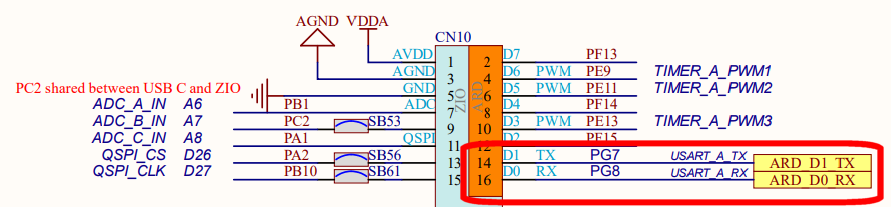

Andrew Neil
@RemHi wrote:
I suspect a pin conflict but reading the documentations, I was not able to find the problem?
It's here:
Both the NUCLEO-U575ZI-Q and the X-NUCLEO-WB05KN1 are driving their VCP onto the Arduino D0-D1 pins.
You're going to have to disable one of them.

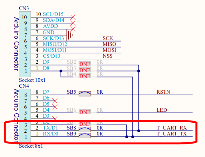

Maybe I wasn't clear. I do not have issue flashing the board. I can make the WB05KN1 working on the nucleo board when mounted alone. But when I also mount the IKS4A1, its not working anymore (I didn't change anything in the binary used to flash the nucleo board).
As long as I understood, these pins are used for the UART communications between the NUCLEO-U575ZI-Q and the X-NUCLEO-WB05KN1.
In my mind this can't be the problem because when mounted alone on the NUCLEO-U575ZI-Q, I could used the X-NUCLEO-WB05KN1 (using the SensorDemo_BLESensor-App example project). I used ST BLE Sensor APP for smartphone and I could see the bluetooth signal and received data.
I only got a problem when I add the IKS4A1 shield between the X-NUCLEO-WB05KN1 and the NUCLEO-U575ZI-Q. It seems not to work anymore (still using SensorDemo_BLESensor-App) = with ST BLE Sensor I can't see anymore the bluetooth signal.
Ah yes, my mistake - they are swapped TX-RX and RX-TX.
So have you used the debugger to see what's happening?
Or an oscilloscope or logic analyser on the pins?
Instead of mounting the IKS4A1 between the others, have you tried making it the bottom or top of the stack?
What if you use wire links to connect just one interface at a time ... ?
