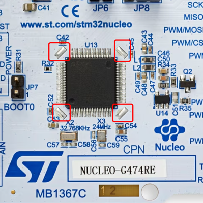

I noticed two holes at Bottom of the MCU area on the STM32G4 Nucleo board. What is their purpose?stm32 g4.jpeg

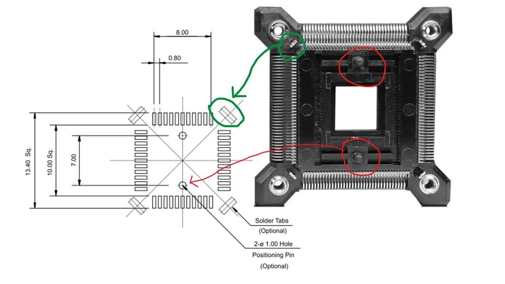

I see it also on Nucleo-L476RG (haven't checked further).
I don't know, but I think it might be to facilitate a QFP socket?
ISTR seeing some early Nucleos with sockets - probably used only internally by ST?

There is no need to have them on a target board.
waclawek.jan
As @Andrew Neil said, it's for a ZIF socket. It's even listed in the BOM
HW110Yamaichi socket for LQFP64, with positioning pins.LQFP64YAMAICHIIC149-064-169-B5Not Fitted0
It's not populated on the boards which are sold to the public, but ST uses them for development internally.

@Kavi I suspect that's also what the four solder pads at the corners of the QFP footprint are for:
I confirm.. these solder pads are used to solder the socket.
