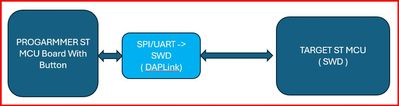

Hello Team,
We want to have Standalone Programmer based on ST`s Existing Flash Module Like St-Link V2, V3 Or Mini PCB tools.
I should be able to Use External ST MCU to Command this SWD module for Flashing n all task , like CubeProgrammer.
Basic Interface like Pushbutton to Start the Flash and Some LED to showcase any Error.
We would not prefer expensive available off-the-Shelf Programmer like Segger..... Not want to use Rpi as well.
This basically for FAE.

bsuthar
Senior
 @Andrew Neil ,
"So why not use a UART or SPI bootloader?"
if u are talking about system bootloader , In that case I have to exexute BooT0 pin & RST pin High low Seqence mechanisum , Manually. Not directly , plug n Play. Also, System bootloader access not available after RDP1.
For , "Again, look at DAPLink: that will show you how to have one microcontroller program another."
Are you talking about Following Scenario ? Just confirming if we r on same page.
Not really sure what you're saying there?
My point is that DAPLink includes code to enable one microcontroller to drive the SWD lines to program another microcontroller - so that's the part you need to extract.
(You will, of course, also need some way to get the code from your development system into your programmer)
