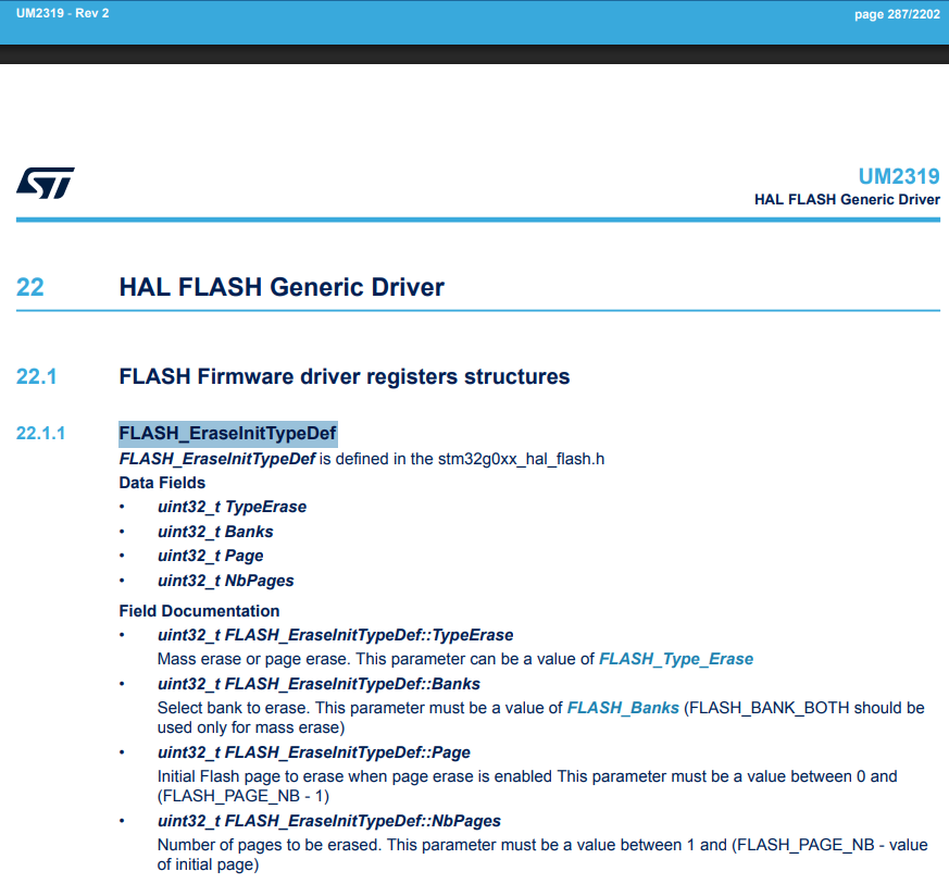

@jo512 wrote:
I will have to erase around 50 pages. How do I do this? Should I make an array or 50 variables, initialize it statically
You can re-use one structure.
@gbm's point was to ensure that there are no uninitialised fields in the structure.
PS:
As @TDK suggested, you can see the definition of the FLASH_EraseInitTypeDef in the source code.
It's also in the User Manual for the Firmware Pack:
https://www.st.com/resource/en/user_manual/um2319-description-of-stm32g0-hal-and-lowlayer-drivers-stmicroelectronics.pdf#page=288
via: https://www.st.com/en/embedded-software/stm32cubeg0.html#documentation
via: https://www.st.com/en/evaluation-tools/nucleo-g0b1re.html#tools-software
So, with your original code:
    /* Prepare erase configuration */
    erase_init.TypeErase = FLASH_TYPEERASE_PAGES;
    erase_init.Page      = page_index;
    erase_init.NbPages   = 1;
you leave the .Banks field uninitialised.
With this code:
FLASH_EraseInitTypeDef erase_init = {
    .TypeErase = FLASH_TYPEERASE_PAGES,
    .Page      = page_index,
    .NbPages   = 1
the the .Banks field at least gets initialised to zero - but that still may not be correct...
Did you try:
erase_init.Banks = FLASH_BANK_1;
or
erase_init.Banks = FLASH_BANK_2;
depending on where the page to be erased is.
Flash is 128 pages per bank. See "3.3.1 FLASH organization" in the reference manual.

So did properly setting erase_init.Banks help ?
Hi All
As expected
    .Page      = page_index,
    .NbPages   = 1
did not work, but setting the bank to 1
seems to work
