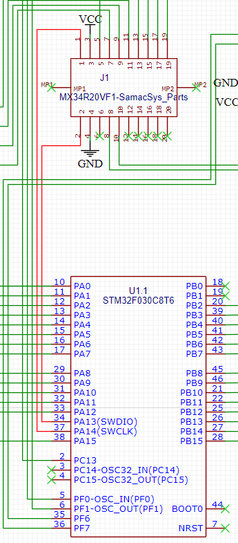

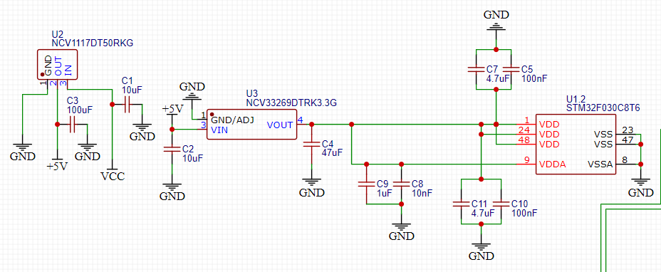

Also, I've checked the schematics, the power is well connected as you can see here :
0693W00000GZMjgQAH.pngThe SWD and SWCLK are connected to an external connector :
0693W00000GZMk0QAH.pngThen I have the power from a power supply with 3.3V.

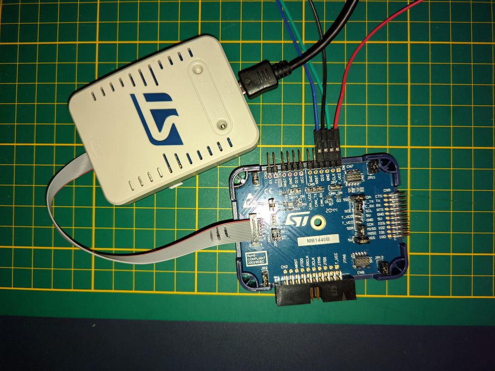

I've connected this way to the ST Link :
0693W00000GZMn4QAH.jpgRed : 3.3V
Green : SWCLK
Black : Ground
Blue : SWD

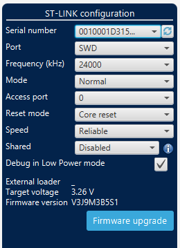

As for the software I'm using STM32CubeProgrammer
Here is the config and you can see the 3.3V is read :

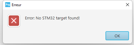

0693W00000GZMogQAH.pngAnd when I press connect I've got this message : 0693W00000GZMpAQAX.pngWhat can I try ?
>>What can I try ?
Try a lower connection rate, 24 MHz is typically too high for CM0(+) devices, start with 2 MHz

A device that is not electrically functional will not respond.
Check NRST is normally HIGH, pulled-up internally
Check power on VDD/VDDA
Check part orientation
Check pin assignments and netlist
BOOT0 is typically pulled LOW externally so the part runs User Code properly out of reset.
