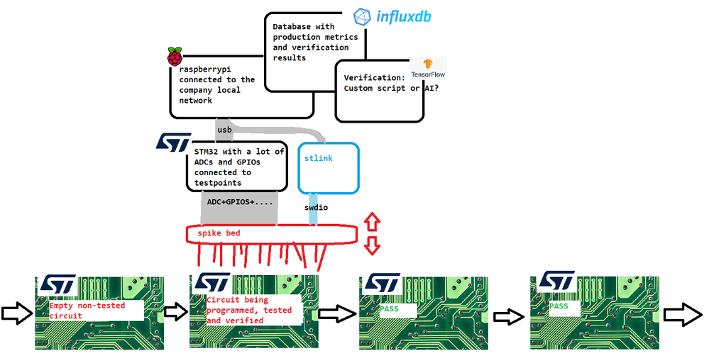

Any *design* ideas about circuit verification after production?
Javier1
Principal
I am planning to automate the Circuit Verification for inhouse designed&assembled electronics, this is my rudimentary idea:
(For me ,the blurry concepts because lack of experience are the Tensorflow and database parts)

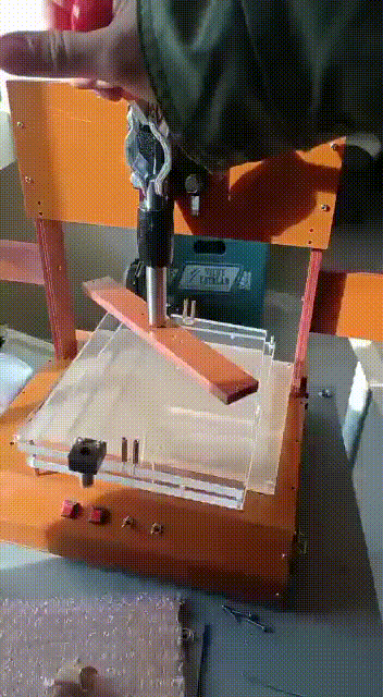

0693W00000GZeWVQA1.png 0693W00000GZecsQAD.gifDoes anyone have experience/ideas that want to share with me?
