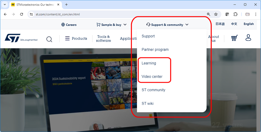

Can You have to give any tutorials complete course regarding STM32 in video format
See also the STM32 MCU Developer Zone:
https://www.st.com/content/st_com/en/stm32-mcu-developer-zone.html
And ST's YouTube Channel:
https://www.youtube.com/channel/UCjnmZw3h4XnpK3e5D2jvIGA
