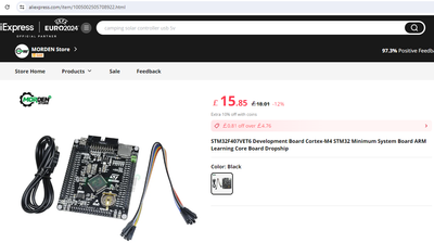

@Andrew Neil wrote:
You still haven't provided full details of that board you're using!
It looks like this one:
but it's impossible to tell for sure - that's why you need to provide full details!
@Vignesh_V wrote:
You have to tell the step by step procedure for set the ST-Link correctly..
We can't do that unless you provide full details of the board you actually have!

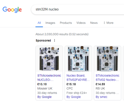

But why make all this trouble for yourself?
Why not just buy a genuine Nucleo board, which comes complete with ST-Link and VCP on board - all ready setup to just plug & play!
The Nucleo board is actually cheaper than your no-name board - even before you add the cost of an ST-Link and a USB-to-UART adaptor:
No I have using ST-Link does not match the original Pin out of you given St-Link .I think in my hand St-Link is not a standard Debugger it is a type clone . My ST-link only support in STM32 Programmer and STM32 ST-Link Utility .If any idea from your side to solve the my problem to see the data through serial. I have Given below link for I actually buying my development board and that full details  website for your reference.
