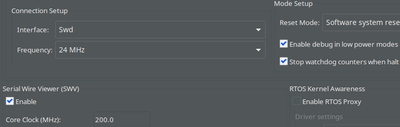

Sep 30, 2025 4:52 PM UTC
>So back to why SWV ITM is not working :)
It IS working...if you do it right, not sooo difficult (but not always working instantly...dont ask me why.).
1. its not working without debug/st-link , because the debug unit has to know, it should do it now.
2. you could write these instructions yourself, without "debug" active, as shown in your link (gist/git...).
3. to send on printf(...) you only need:  (at end of main, see user code marks)
/* USER CODE BEGIN 4 */
int __io_putchar(int ch)
 ITM_SendChar(ch);
 return (ch);
/* USER CODE END 4 */
...then send is simple as:
 printf("**** start *******\r\n"); // always \n needed !
enable in debug SWV: (cpu core clock has to be the real clock value ! !  here 200MHz )
set itm0 , when debug started, wait at main, in SWV settings:
+ "start" with the red button
-> then run program and get the messages you send:
btw
sometimes its not working on the first run, end debug, start it again, red button again...
funny: if its working, its always working, also after mod code, compile, debug...no need to start it again... :)
Without debug etc its more easy and straight : use one of the many uarts, set it on (i do) 3 Mbit, transmit only;
on a plug you can connect to a running machine and see the messages, without stopping or changing the "normal" running status; no debug session needed.

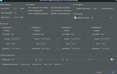

AScha.3
Oct 1, 2025 7:34 AM UTC
>disabling PC Sampling is now a requirement for the SWV ITM debug console to work.
No, just think: there is a buffer with fixed size (2MB or so) and if you switch on sampling, it is filled quite fast, depending on sampling rate. So if you want see the cpu/task statistics , you only can run the from debug/pause to pause debug again some seconds or minutes (set buffer to 10x default size, as i do, helps for longer statistics);
then switch off sampling , or if want statistics again, clear the trace buffer. (Same with live watching -> graph.)
To adapt to the resolution of sampling you need, set the prescaler (longer time for sampling, but lower time resolution.)
So usually sampling has to be off, to run only SWV messages and view them in swv console without filling the buffer in short time.  And set more buffer size  than default,  for more/longer sampling time.

AScha.3
Oct 1, 2025 10:50 AM UTC
Yes, as i said: working fine, see here example for profiling: maybe one minute running (top part...> 1%)

PHolt.1
PHolt.1Author
Senior
Oct 1, 2025 1:21 PM UTC
What settings do you have here?
AScha.3
Oct 1, 2025 1:34 PM UTC
...about same (just other cpu , H743 H7A3 , clock etc. );
and debug (mostly i use OCD ) software reset:
uncheck PC sampling, if not looking for statistics.
