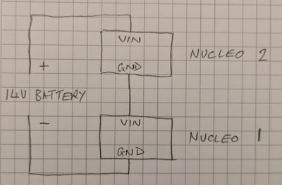

I would also like to know if i Have a 14 Volt battery, if I can directly put 2 boards in serial, the regulator inside of them making always sure that the tension is stable even if there is current variation in the circuit.

 I put 2 boards in serial.
I think it's better to plot a sketch
Indeed. As they say, a picture is worth a thousand words!
This is particularly true in engineering (including electronics), where trying to describe systems in text alone is difficult at the best of times - and even worse when there's a language barrier.
I'm guessing that "2 boards in serial" means that they are wired in series across the 14V supply:
I don't think that will work: the 7V just specifies the the voltage applied to the board's input - it does not mean that the board will drop a constant 7V!
This can be seen by the fact that the board can be supplied with up to 12V - see Table 5 again.
And that's before you consider the issues that the 2 boards will have different GND potentials ...

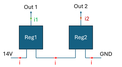

This is what you are trying to do:
The current i depends on the loads on regulator 1 (reg1) and regulator 2 (reg2) outputs i.e. i1 and i2. Suppose i2 changes, i changes and risks to disturb the current on reg 1 output (i1) and vice versa.. -> risk of bad regulation.
