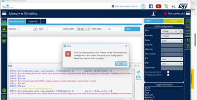

I am trying to do UART bootloader, using cli command.
The MCU used is STM32F446RET6 and dev kit used is nucleo-f446re.I am using USART1, for printf and cli command with interrupt. CLI command is used to enter system memory /bootloader but as shared above the programmer is not giving timeout error.

Hardware connection - NUCLEO PA9,PA10-UART1 connected to FTDI cable,USB cable connected for power supply the nucleo board which is used for STLINK.

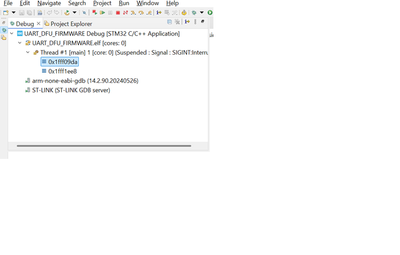

after running my project ,as suggested by the document the Debugger suggest that my MCU is inside System Memeory (0x1fff0000).but i still get timeout error.
Is there any hardware change required for Nucleo board
