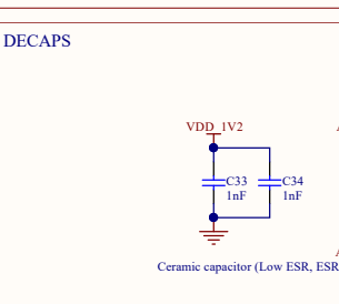

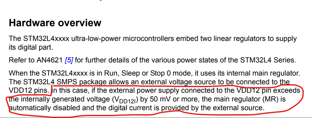

In AN4978 it says: 0693W00000QLNYvQAP.pngFrom these sentences, can i assume that if i leave VDD12 with NO EXT SMPS AT ALL it is okay since the internal LDO will supply the internal logic?
Also, what do i do with these pins? i examined the STM32L452RETP NUCLEO Evaluation board and saw 2 1nF caps for the VDD12 pins.
0693W00000QLNZFQA5.png So what do i do with the VDD12 Pins if i do not use ANY EXT SMPS?:
1) Leave floating
2) Connect a cap to GND.
Thanks in advance,
Ido

Piranha
Chief II
From AN4555.
Section 2.1 Power supplies:
VDD12 ... It does not need any external capacitance and cannot drive an external load.
Section 2.2 Power supply schemes:
As these VDD12 pin are also connected to internal regulators, they cannot accommodate a decoupling capacitance, neither can they be shared with an external circuitry for other purposes.
Figure 3. Power supply scheme: no components connected to VDD12.
