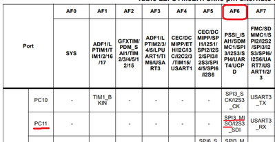

Hi, I have a problem configuring SPI3 on a NUCLEO-H7S3L8 board.
I’m writing directly to registers and not using any ready-made functions. I configured SPI3 and everything works correctly as long as I use PB4 as MISO. However, I wanted to use PC11 instead, and then I only read 0xFF.
I’m using exactly the same settings for PC11 as for PB4, and both are configured with AF6.
My question is: does PC11 require any special configuration, or maybe something on the Nucleo board blocks it from being used this way?

Nothing special from NUCLEO board side. PC11 is exposed to both connectors and nothing already connected to it on the board according to its schematic.
What I suggest is to:
1- Start by toggling PC11 and check if it is toggling as intended.
2- Check if you already enabled RCC clock of PC port.
3- Check if you've selected the correct alienate function for SPI3_MISO on PC11. Did you select AF6? (you said you did it but please check):
