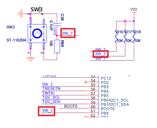

I'm using STM32L412RBT, LQFP64pin.
As the attached schematic, we are using some GPIO's as BTN inputs.
But, unfortunately, the GPIO got damaged very easily without special reason.
The pin voltage stuck at 1.0 ~ 1.7V when the button is not pressed.
We assembled 10 boards, and 3MCUs has this problem.
We had used the similar schematic with STM32F201, STM32F767, and so on.
But, this is the first time we're using STM32L412RBT and now we have problem.

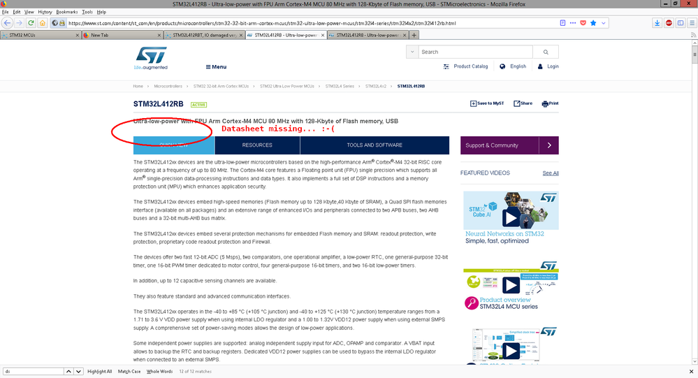

Imen.D
Hi @Community member​ ,
You are right, I already raised internally this error for a fix.
Note, Datasheet is accessible from STM32L412CB or other product pages.

I suppose the question I would be asking is why this happens on SW3, but not on SW2. (I assume they have similar external circuits).
And looking at the data sheet, I see that PB8 for SW3 has an I/O structure of FT_f whereas PB3 for SW2 has an I/O structure of FT_a.
What's the difference? They're both 5V-tolerant. But FT_f isn't something I have seen on stm32f7. It seems to be a new structure intended to allow the pin to be used for I2C at 1 MHz.
I don't see an errata document for stm32l41x, so maybe this is a fairly new family for which ST are still preparing the document. Also I see in the data-sheet, Table 19 current characteristics has a different line for FT_f maximum sink current, but the same absolute-maximum value. And in table 70, the FT_f pins can sink much harder when in FM+ mode.
So my next question is should FT_f pins be treated differently?
Is it a weakness in ST's circuit-design?
Do you ever (even at start-up or during production-testing or as a transient when setting up the pins) set PB8 as an output?
How (I didn't see it glancing through the reference manual) does one select FM+ mode for FT_f pins? Is it possible these pins are accidentally ending up in that state.

The 'L422 errata mention PB8, in a weird context of 48-pin SMPS package, which in turn is missing in the 'L422 DS... The 'L422 is most probably the same silicon die as the 'L412, only with enabled crypto.
What's the behaviour of the PB8 pin during reset, i.e. when NRST is grounded?
Is the PB8 behaviour as if a cca 10kOhm pulldown be enabled, i.e. if you change the external pullup, does the output voltage follow linearly?

What is the GPIO configuration, what is the content of GPIOB registers ? (MODER, PUPDR) ?
FM+ is enabled inside SYSCFG_CFGR1.
All button input pins are configured to be
input mode
no pull-up, no pull-down
Did you verify this by actually reading out the content of relevant GPIO registers?
