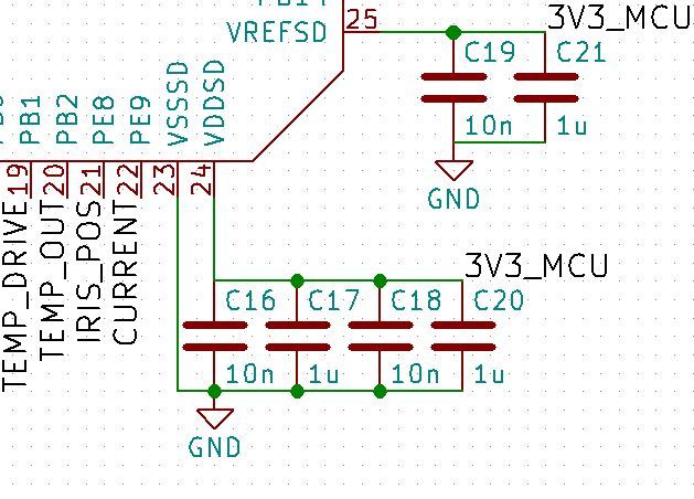

Hello everyone,
Could I please get a little bit of help with getting the STM32F373 SDADCs working?
The chip is an STM32F373CBT6, with VREFSD+ and VDDSD both connected to VCC (3.3V). I've followed the ST guidelines on decoupling capacitors, all the caps are on the opposite side of the board (it's only 0.8mm thick) just about as close as I can possibly get them to the pins. Schematic of that section of the board:
Current code:

I'm not using HAL because I'd prefer to have low-level access to the hardware; this way I know that all the registers are set up properly. Clock in this case is 72MHz CPU, divided by 6 to get 12MHz, and then the SDADCs have (according to Figure 12 on page 102 of RM0313) a further division by 2 to drop it down to the SDADC preferred 6MHz operating clock.
At the moment I'm trying to get SDADC2, Input 7 (port E9, ''CURRENT'') to work. This is connected to an Allegro ACS711
current monitor, which should output about 1.65V + 110mV/A (since the only things using power are four SMD LEDs and the STM32, total power draw is next to nothing). The ADC is set up for single-ended zero-referenced mode, gain bits 000 (ie gain 1X), so I'd be expecting a value somewhere around 32800 - 32900. What I actually get (both output on the UART and seen in the debugger) is 0x4FA (1274 decimal, about 64mV).

Good news! Just as the moderators approved this post I figured out what was going on.
The problem was a misunderstanding of ST's 'zero-volt reference' and 'offset' modes (the 'zero-volt reference' mode applies a Vcc/2 offset, and the 'offset' mode applies no offset). I'm now getting 1.345V (temperature) and 1.712V (current) - which is about as close as I can reasonably expect to get.
So, the chip is fine, the SDADCs are working correctly, it was just a failure to read the datasheet properly.
