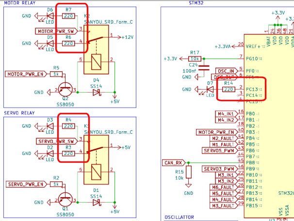

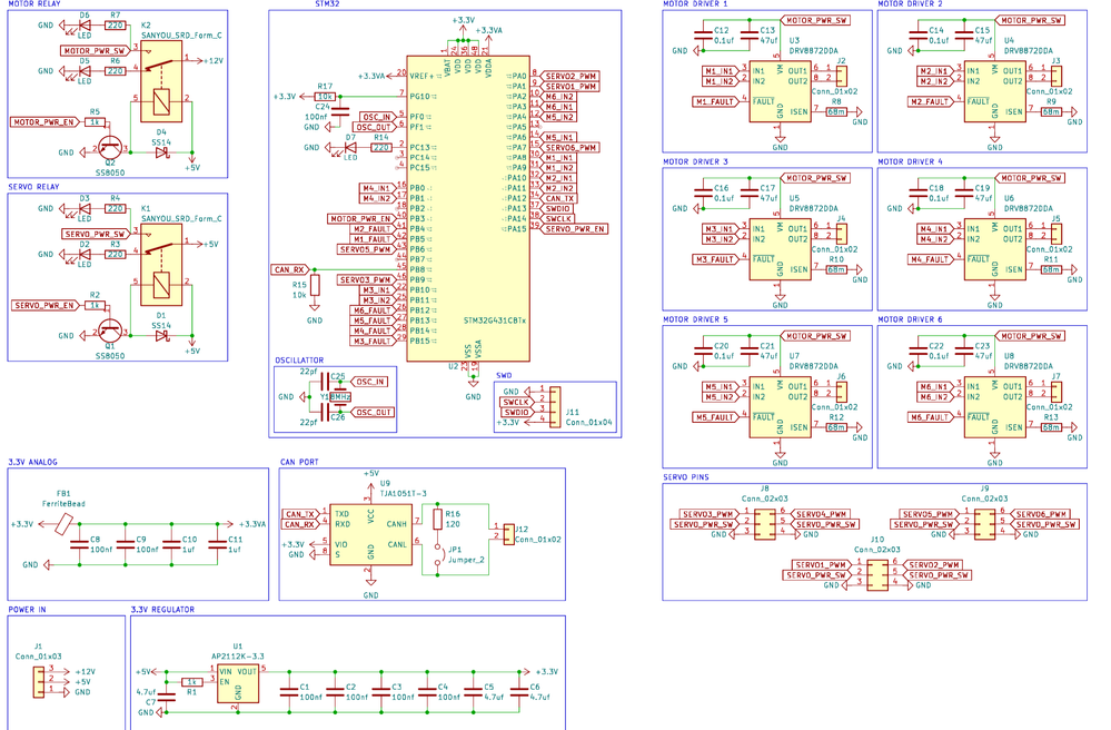

I designed a custom control board based on STM32G431CBT6 and before manufacturing the PCB I would like to make sure there are no fundamental hardware mistakes.
My main concern is not firmware but hardware connections.
I would appreciate if you can review especially:
  • SWD programming interface connections
  • Power supply and decoupling capacitors
  • BOOT0 and NRST configuration
  • VDDA and VREF+ connections
  • CAN transceiver interface (TJA1051/3 with VIO = 3.3V)
  • Anything that may prevent programming or startup
The goal is to verify that the MCU can be programmed and start reliably after assembly.
I am attaching the schematic below.
Thank you very much for your time.

Best answer by TDK
  • PC13 shouldn't be used to drive an LED.
  • NRST (PG10) does not need an external pullup, as it has an internal one. This will work though.
  • I recommend using a standard debug header rather than 4-pins that you need to connect manually. Note that programmers typically don't provide power.
Otherwise, looks good.
Indeed.
But it is OK for these pins to sink current; eg, for an LED:

For the relays control I suggest a GND isolation/separation using optocouplers to avoid any high-voltage spikes, and noise generated by relays coil and the relay switching, otherwise you may face unwanted resets of the MCU.

Include NRST on the programming connector.
If possible, have a UART for diagnostics

"BOOT0 and NRST configuration"
You don't have a provision to use BOOT0.
Consider moving your CAN_RX to a different pin so that you can utilize BOOT0.
And as Andrew said, "If possible, have a UART for diagnostics" + reprogramming flash with bootloader.

@tuncayarda all of your LED series resistors are 220 ohm:
Shouldn't the 12V ones (D2-3, D5-6) be higher ?
