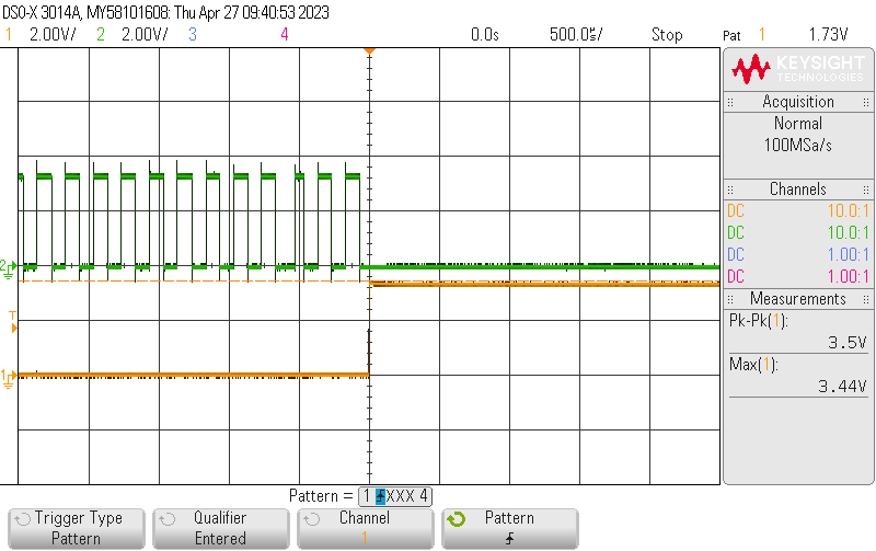

KYou.1
Please take a look at below output.
CH1(Yello) is hooked up to the PE1 pin
CH2 (Green) is hooked up to a gpio toggle from the program.
As soon as the PE1 pin goes high(the limit sensor is cleared), the toggle output stops.
After a one or two seconds the program restarts again.

So it's PE1 going HIGH that seems to be the trouble, not LOW.
